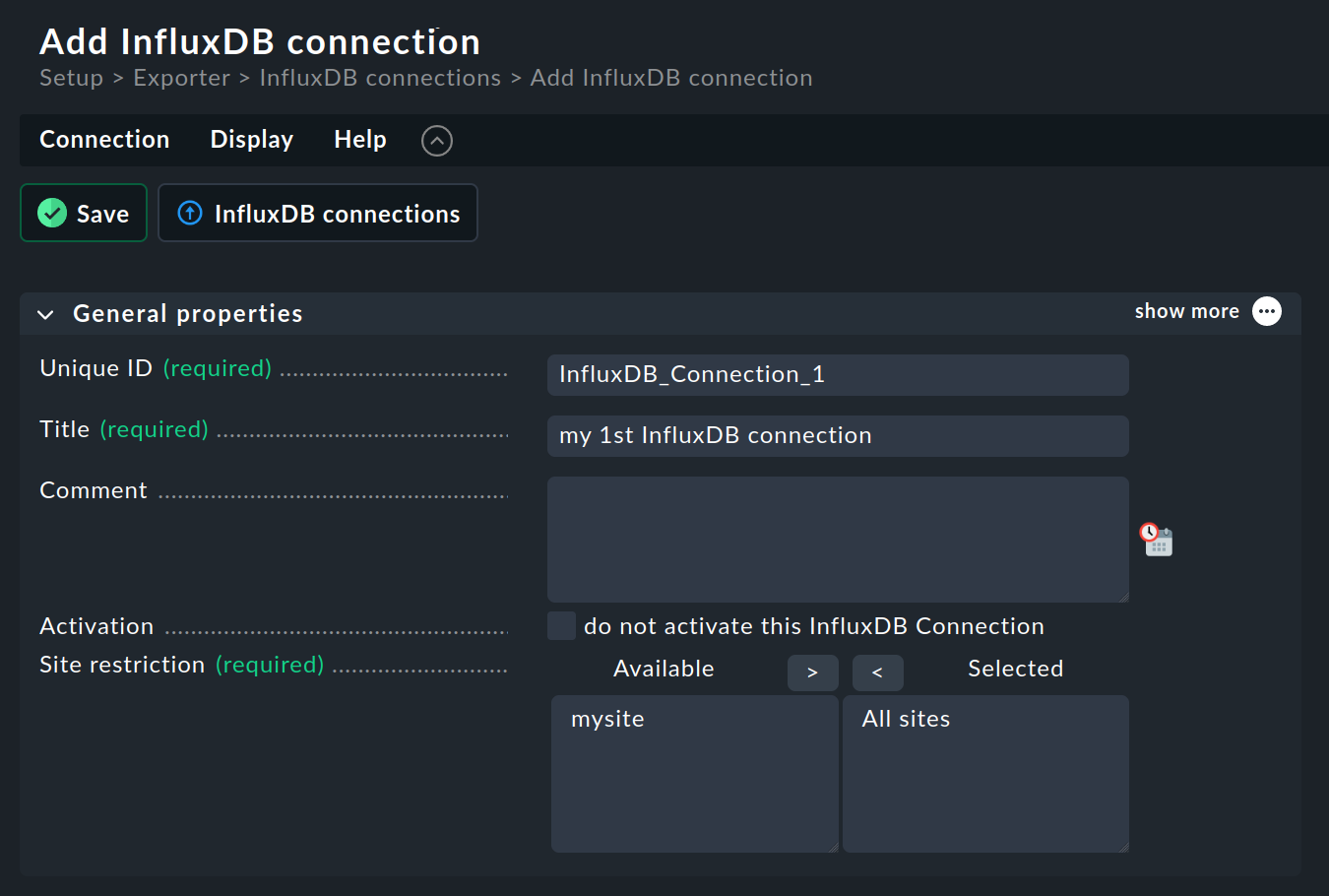

So first create a new connection with Icon to create a new connection. Add connection:
The general properties of an InfluxDB connection.
ID, title and site selection are enough for the general properties
In the General properties, you specify the internal ID and title for the connection, as usual.
If there are other sites connected to the current site, as is the case with a distributed monitoring, you can restrict the connection to specific sites under Site restriction. To do this, first move the All sites entry to the left column and then move the sites that should receive metrics from the left to the right Selected column. The sites that will not receive metrics then remain in the left column.

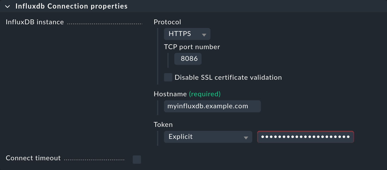

We then continue in the next box with the InfluxDB Connection properties:
Setting the InfluxDB-specific connection properties.
Setting the InfluxDB-specific properties
Here enter the first set of parameter values you compiled in the previous section.

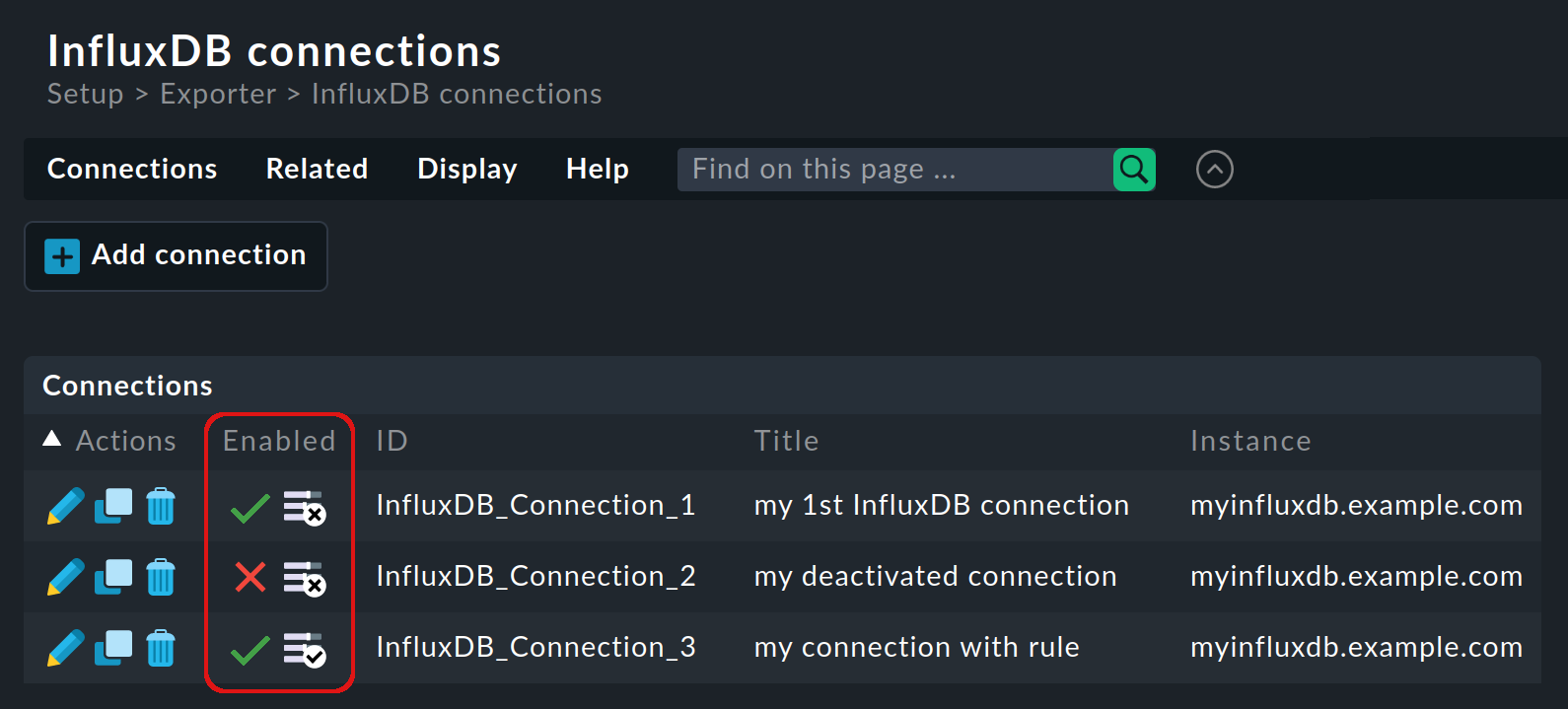

Save the connection with Save and you will return to the list of connections:
List of InfluxDB connections.
Active, inactive, with or without rule? The connection list shows the configuration
In the connection list, the Enabled column shows important information about the state of the connection. Don’t be surprised to see three entries in the list in the above screenshot: To be able to see all of the symbols in action, we have added two more connections to the list. From the first column in Enabled you can see whether the connection is Icon showing an active connection. enabled, or is Icon showing a disabled connection. disabled. In the second column you can see whether there is already a rule for Button to display the list of rules in the ruleset. the connection, or Button to create a new rule. not.
No data will be sent over a connection until it has been associated with a rule that selects the metrics information. This rule is called Send metrics to InfluxDB. The rule icons are buttons and provide a shortcut to rule creation. For a connection with a rule, click Button to display the list of rules in the ruleset. to open the rule set overview page, which highlights which rule takes or would take effect for the connection. For a connection without rules, clicking Button to create a new rule. takes you directly to the rule creation page.
In the following chapter we will describe in detail what can be specified in this rule.

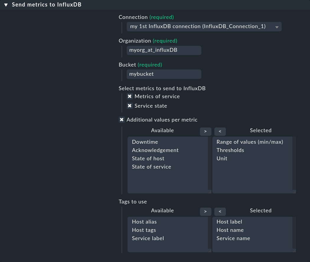

In the Send metrics to InfluxDB box, first select the connection created in the previous section and then specify where the data will be stored on the InfluxDB server. Here, enter the second set of collected information for the InfluxDB server. Use Organization to decide which users receive the data, and Bucket to decide how long the metrics are kept. Multiple selection is not possible, i.e. you cannot send the metrics to multiple buckets for use by different organizations, for example.
Below you select the metrics data that will be sent from Checkmk to the InfluxDB server. Metrics of service is already selected by default and enables the sending of metrics. Checking the Service state checkbox will send the service state as its own metric.
After enabling Additional values per metric you can add a number of meta-data to the metrics for display purposes, e.g. the State of service and the Thresholds. Note here that Unit currently only works for metrics from active checks if these support it. The reason is that only active checks have an option to supply the unit and the CMC has no access to others.
In the last selection menu, Tags to use, meta data such as host tags or labels are added to the metrics, which are mainly used for filtering and have been optimized for this purpose. The Host name and Service name selected by default are mandatory entries that cannot be deselected.
In InfluxDB, the Additional values per metric are stored as fields and the Tags to use are stored as tags.

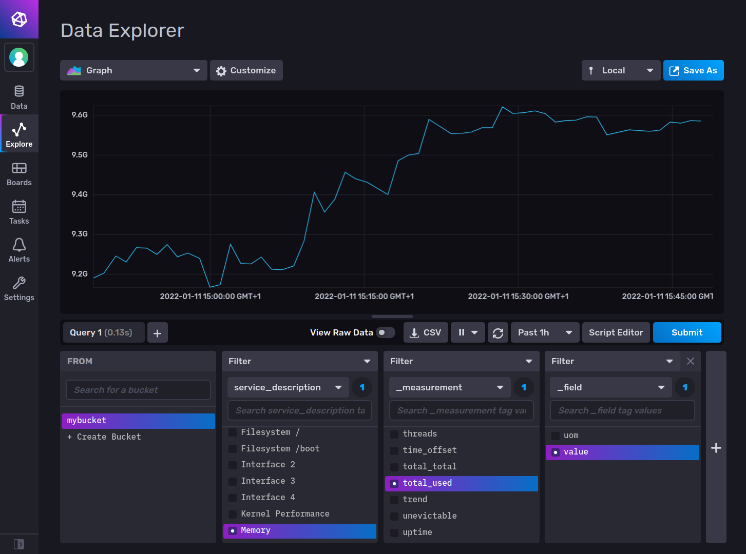

2.4. Displaying metrics in InfluxDB
Once the metrics from Checkmk have arrived at the InfluxDB server, they can be displayed in the InfluxDB GUI. As an example, the following image shows the graph for the total_used metric, which shows the amount of memory used:
Display of the used memory metric in the InfluxDB GUI.
In the InfluxDB GUI, below the graph there are lists for selection and filtering
Note: This metric can be found in Checkmk at the Memory service under the metric named Total used memory.

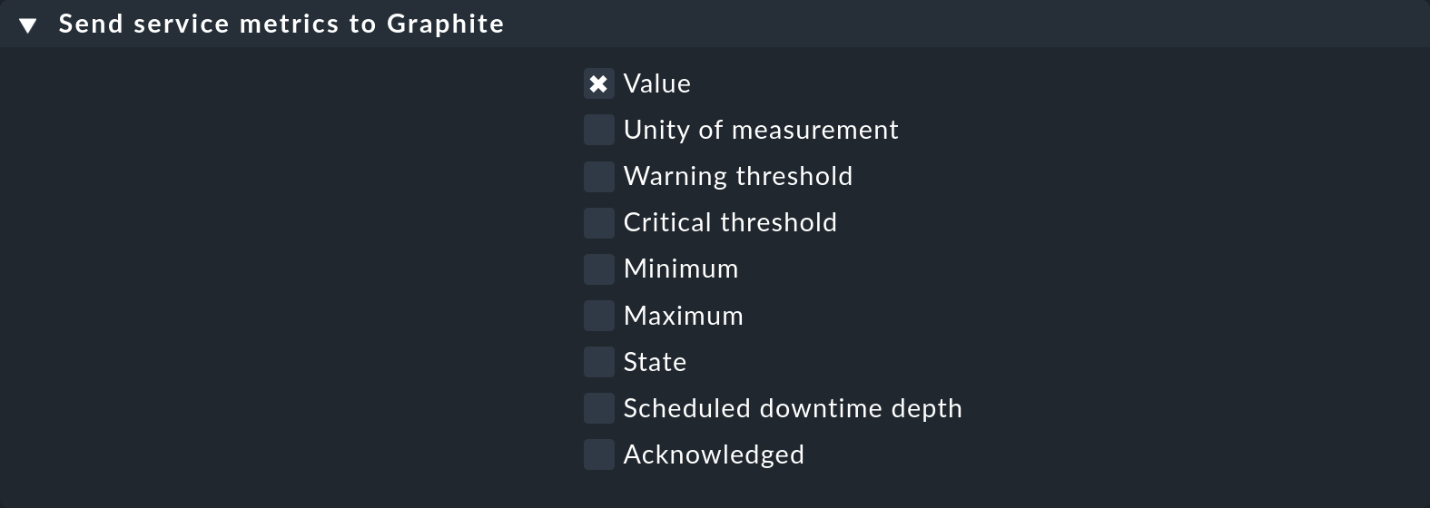

In Checkmk under Setup > Services > Service monitoring rules you will find the two rule sets Send host metrics to Graphite and Send service metrics to Graphite. The configuration is carried out in the same way for host and service metrics. We show the configuration for service metrics here. You then set up the host metrics in the same way.
You can use the Send service metrics to Graphite rule to select the values to be sent with the metrics:
Rule for selecting the service metrics to send over the Graphite connection.
Likewise with Graphite the selection of the metrics information is done by rule

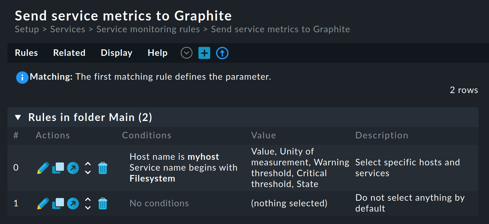

Secondly, you can restrict sending to certain hosts and services in the Conditions box. Since without a restrictive rule all data will be sent, it is recommended to first create a rule that disables sending globally by unchecking all of the check boxes shown in the above screenshot. Next, create a specific rule with the desired metric information for the hosts and services whose metrics should be sent to the Graphite server. Sequence the specific rule before the global rule:
List of rules for sending over the Graphite connection.
By placing the two rules in this sequence, only service metrics from the host myhost will be sent

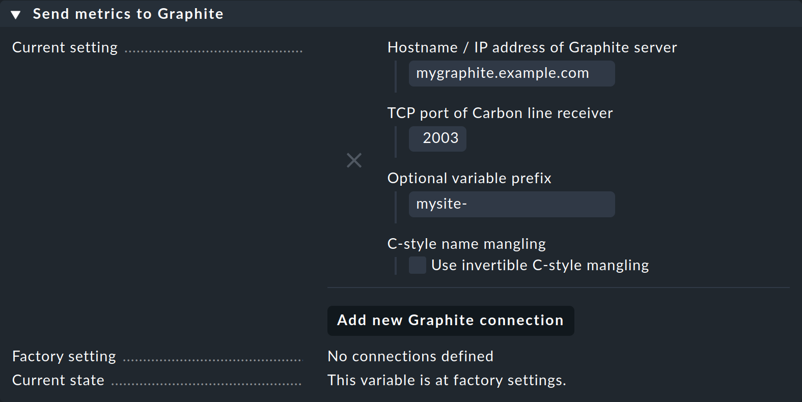

You set up the connection to the Graphite server under Setup > General > Global Settings > Monitoring Core > Send metrics to Graphite. Click there on Add new Graphite connection:
The properties for a Graphite connection.
The Graphite connection will be created in the Global Settings
In addition to the obvious Graphite server details (the port name and number for the Carbon plaintext protocol), you can also use Optional variable prefix to configure a prefix to be added to each host name, e.g. to enforce unique names. Checkmk sets the metric path for the plaintext protocol to <host>.<service>.<metric>.
An activate changes for the rules and connection completes the configuration for Graphite.

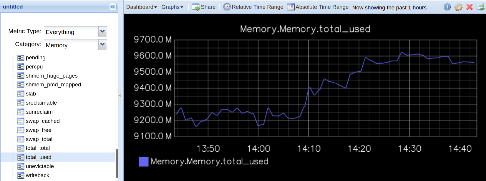

3.3. Displaying metrics in Graphite
In the Graphite GUI you can also view the metrics received from Checkmk. The following image shows the graph for the total_used metric that we have already shown above as an example in the InfluxDB GUI:

In the Graphite GUI the selection is made in a navigation panel to the left of the graph
