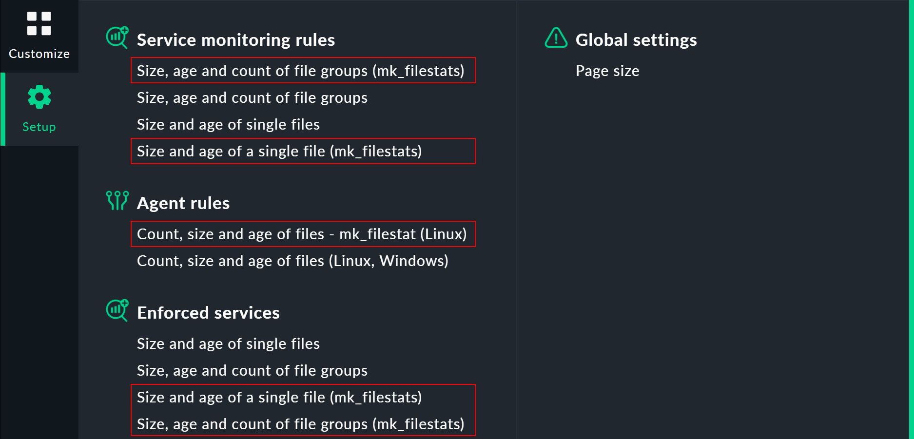

2. The differences between mk_filestats and fileinfo
If you want to see the rule sets for the two variants side by side for the sake of clarity, simply type size age in the Setup menu. The rules for individual files and groups are named (largely) identically, but the mk_filestats rules are explicitly identified as such. Both variants of service rules are additionally available as enforced services.
Setup menu with mk_filestats and fileinfo entries.
fileinfo rules are not explicitly marked as such
Differences between the two variants exist at the agent and service levels. To begin with, here are the basic theoretical differences. You will find specific details later in the instructions for the mk_filestats agent plug-in as well as for the agent’s fileinfo.
In the case of the agent, mk_filestats is distinguished by two options that fileinfo lacks: Firstly, mk_filestats offers the additional filtering options already mentioned, namely by file size, number and name, the latter in the form regular expressions. For example, with a /myfiles/* globbing pattern, you could bring only those files into monitoring that are larger than 1 KB and contain backup somewhere in the filename. On the other hand, with mk_filestats, file groups are also specified directly in the plug-in configuration, simply by creating multiple filters, each of which then ends up as its own section in the agent output and which can later be addressed by rules via the section header.
For service monitoring rules, the approaches used by mk_filestats and fileinfo differ more in their details. Both can restrict evaluations to specific time periods, but only fileinfo allows explicit specification of time windows per day directly in the rule. Also exclusively, fileinfo can configure so-called conjunctions for file groups. This associates a set of conditions for each status, so for example: "The status goes to CRIT as soon as the oldest file in the group is exactly 5 hours old and the smallest file is exactly 8 megabytes." In turn, for file groups, mk_filestats provides the option to define outliers: Suppose a file group is supposed to go to CRIT as soon as the group size exceeds 2 gigabytes. However, if the group should not go to CRIT when a certain single file alone exceeds 1 gigabyte (such as a temporary file), you can define this as a special case, overriding the group rule on a case-by-case basis.
An overview of the differences:

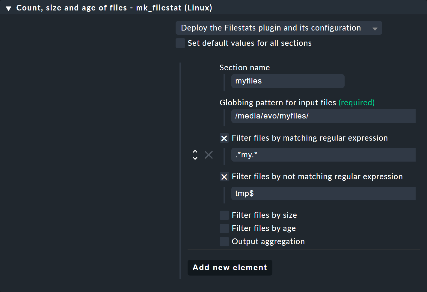

3.1. Configuring the rule for the agent plug-in
Configuration via the Agent Bakery
CEE In the commercial editions, first call the rule for the agent plug-in Setup > Agents > Windows, Linux, Solaris, AIX > Agent rules > Count, size and age of files - mk_filestats (Linux). Under Section name you assign an arbitrary name, which appears later in the agent output as an independent section.
Under Globbing pattern for input files you then specify which files are to be monitored. You can use globbing patterns, i.e. ultimately file path specifications with placeholders. At this point, we want to use an absolute path specification that includes all files in the specified folder.
Further filtering is done by the next two options: Filter files by matching regular expression includes files according to a specified template, in this example files with my somewhere in their names, and Filter files by not matching regular expression which then excludes files, here those ending in tmp.
Form to configure the agent plug-in mk_filestats.
Pay attention to the distinction between globs and regular expressions.
This completes the configuration and you can distribute the plug-in including its configuration via the Agent Bakery.

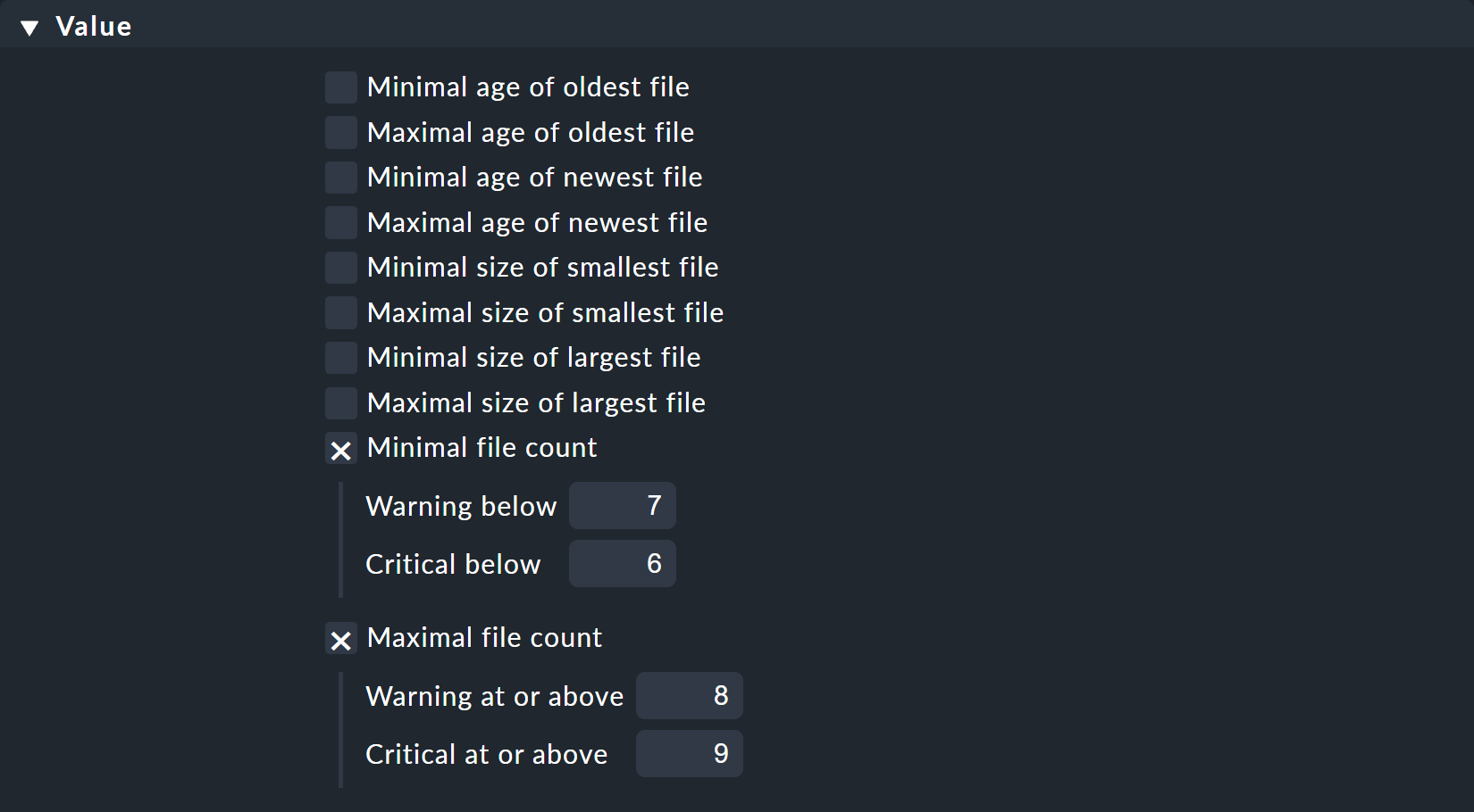

3.2. Service rule configuration
The monitoring now has access to the file data via the agent. For evaluation, call the rule Setup > Services > Service monitoring rules > Size, age and count of file groups (mk_filestats). In our example, we want to be warned as soon as a specified number of files is exceeded or not reached. This is done by the options Minimal file count and Maximal file count, which are used to set upper and lower limits. All other minimum-maximum options work analogously.
Form with upper and lower limits for file monitoring.
Part 1/3: OK are here exclusively 7 or 8 files

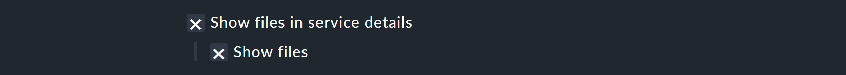

But which file then generates, for example, a CRIT status? The option Show files in service details helps here: If this is enabled, you will see all affected files listed in the service details view.
Specifying to show individual files in service details.
Part 2/3: This option provides transparency — but can also produce very long lists

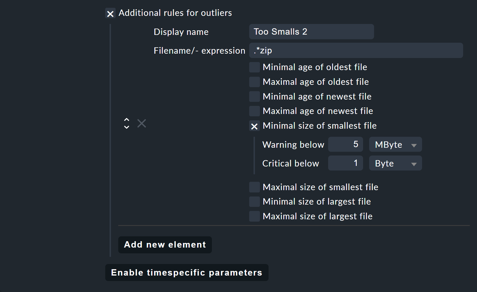

Now it could be that the correct number of files is present, but there are also outliers with respect to their sizes, for example. For such exceptions you can use the option Additional rules for outliers: This specifies, for example, that for files below 5 megabytes the status WARN is set, below 1 megabyte the service goes to CRIT. This can be useful for being notified of possibly defective backups for instance.
Specifying outliers in the monitored files.
Part 3/3: files must be at least 5 MB, otherwise a warning will be issued

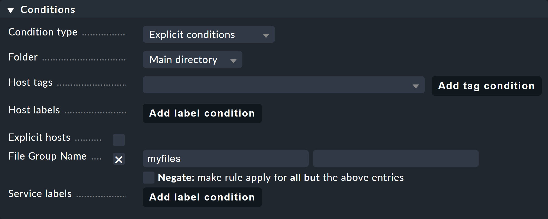

In the Conditions box, you can now specify that the rule should apply exclusively to the myfiles file group configured in the agent plug-in: To do this, enter the name you assigned in the agent plug-in under Section name as File Group Name.
Filter on files in the myfiles group.
File Group Name corresponds to Section Name in the plug-in rule
This also completes the service rule. You could also optionally limit the evaluation to a single time period. Once completed add the new service to the affected hosts and activate the changes as usual.

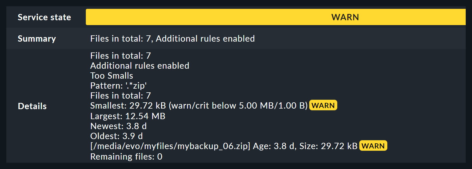

3.3. mk_filestats in monitoring
You can then see the evaluation from the monitoring in lists and, of course, in the details. In addition to the parameters for the service, you will now also be able to see the files that are responsible for the WARN or CRIT status.
Service details in monitoring for the WARN status.
The files responsible for the status are revealed by mk_filestats in the monitoring

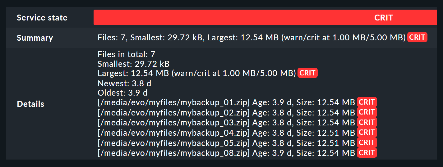

However, caution is advised with the Show files in service details option: If many files have been responsible for a status change, they will all be listed, which can lead to long lists and associated performance and view issues.
Service details in monitoring for CRIT status.
Imprecise regular expressions can produce huge lists

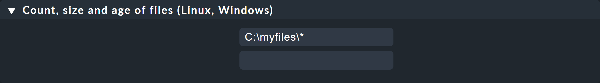

CEE The configuration of the agent in the commercial editions under Setup > Agents > Windows, Linux, Solaris, AIX > Agent rules > Count, size and age of files (Linux, Windows) is much simpler: Here you only define the file path in the form of a globbing template. This also raises the problem of transferring extremely long file lists, which can noticeably slow down monitoring. In addition, a separate service is created by default for each file found, which can only be avoided by forming groups.
Rule for fileinfo with filtering on the Windows path.
Monitoring all files in this exact directory

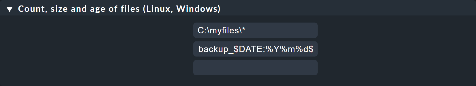

Additional date: On Linux hosts you have the possibility to filter by date: In the globbing pattern, you can use the $DATE variable to include only files whose names contain the current date. The format of this variable is the same as that for the Linux program date.
Rule for fileinfo with filtering by date variable.
Under Linux, files with timestamps in their names can only be addressed explicitly

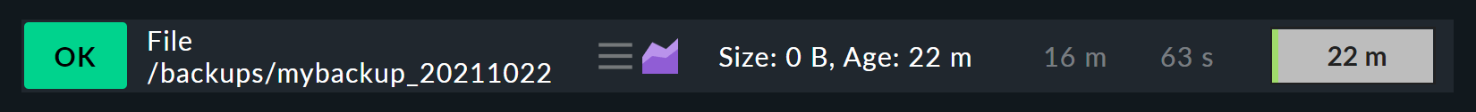

A specification like /backups/mybackup_*_$DATE:%Y%m%d$ would — as of today, 10/22/2021 — consequently find files such as mybackup_01_20211022 and mybackup_foobar_20211022:
File in the monitoring, filtered by the date in the file name.
For backup files, timestamps and a daily check are useful

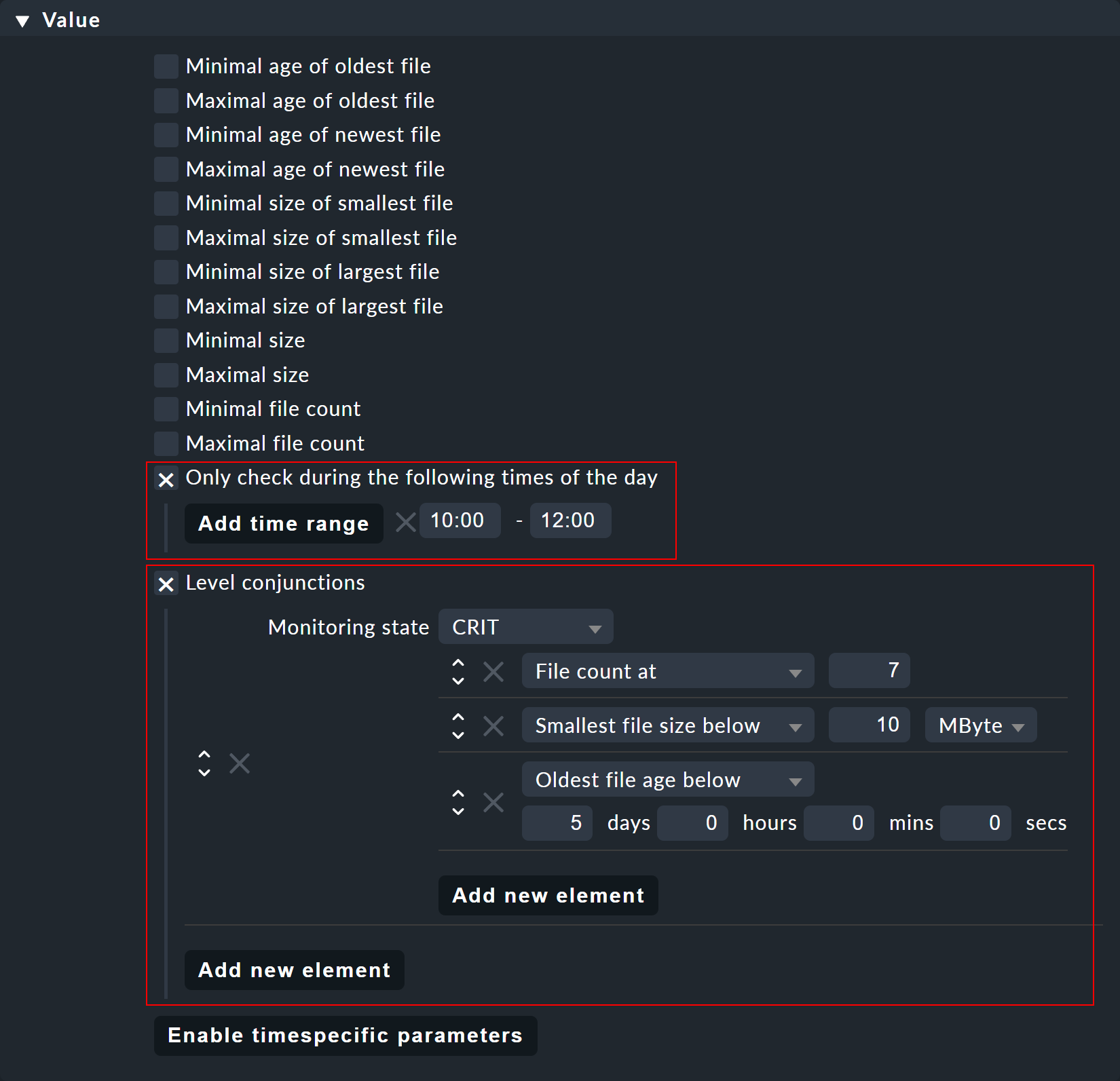

In the second step, the service rule Setup > Services > Service monitoring rules > Size, age and count of file groups is configured again. The minimum-maximum options correspond to those of mk_filestats, but the options for displaying the affected file names in the service details and for outliers are not present here. There are two additional options for this: First, you can directly enter a time period via Add time range — outside this time period the service will always have an OK status.
On the other hand, the powerful Level conjunctions feature is available: This allows you to set series of conditions for each of the four states OK, WARN, CRIT, and UNKNOWN. For example, you could specify that the service goes to CRIT if…​
  • there are exactly 7 files
  • the smallest file is less than 10 megabytes,
  • the oldest file is less than 5 days old
Specifying conditions for files monitored with fileinfo.

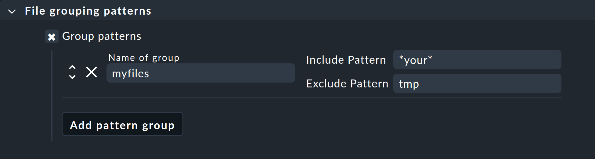

In contrast to mk_filestats, the group formation only takes place in monitoring via the service rule Setup > Services > Service monitoring rules > File grouping patterns. You ensure the assignment by also entering the group myfiles under Group name.
The patterns for files to be included and excluded are not specified here by default via regular expressions, but only via globbing. However, if you prepend a tilde (~), you can also use regular expressions here.
Filtering of files in the group myfiles.
Input fields do not always behave identically — the inline help always provides further details

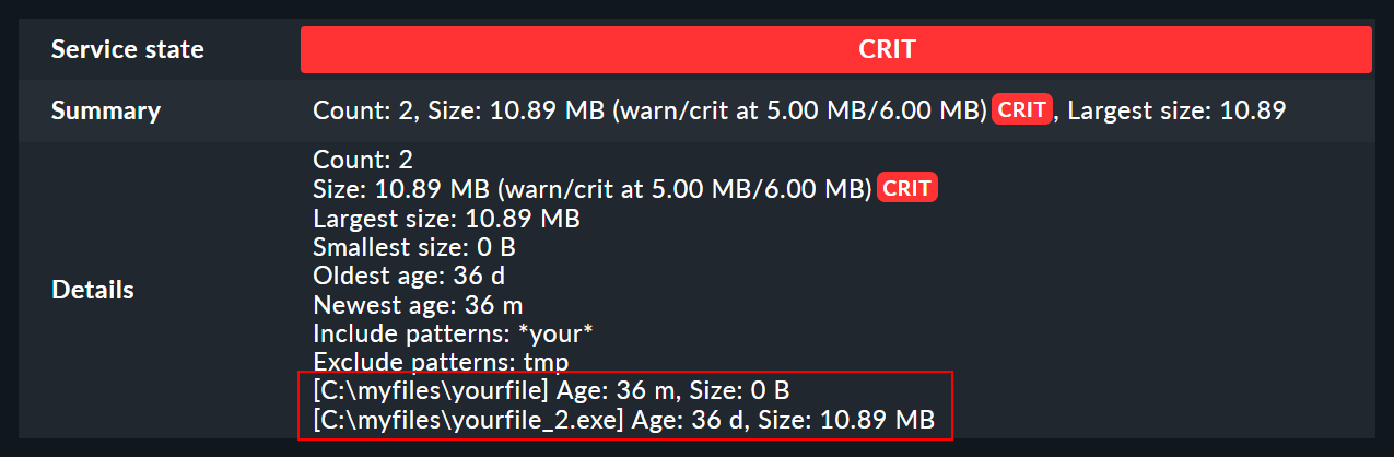

4.3. fileinfo in monitoring
In monitoring, the view of a fileinfo group is not very different from an mk_filestats group. However, fileinfo always lists all affected files explicitly, regardless of whether they are responsible for a status change or not. Here in the example you can see the two files yourfile with 0 megabytes which has no effect on the status, and yourfile_2.exe with its almost 11 megabytes which thus triggers the CRIT status:
A fileinfo group in monitoring.
yourfile is displayed by fileinfo, although it is not responsible for the status change

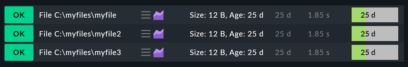

All files delivered to the monitoring by fileinfo and which are not assigned to a group remain as individual services:
Single files as separate services in monitoring.
With fileinfo, imprecise globbing patterns can produce huge lists
This very list shows why it is so important to be precise about filters in fileinfo: For example, if C:\ were specified here without any restrictions, there would subsequently be several hundred thousand individual services in the monitoring.
