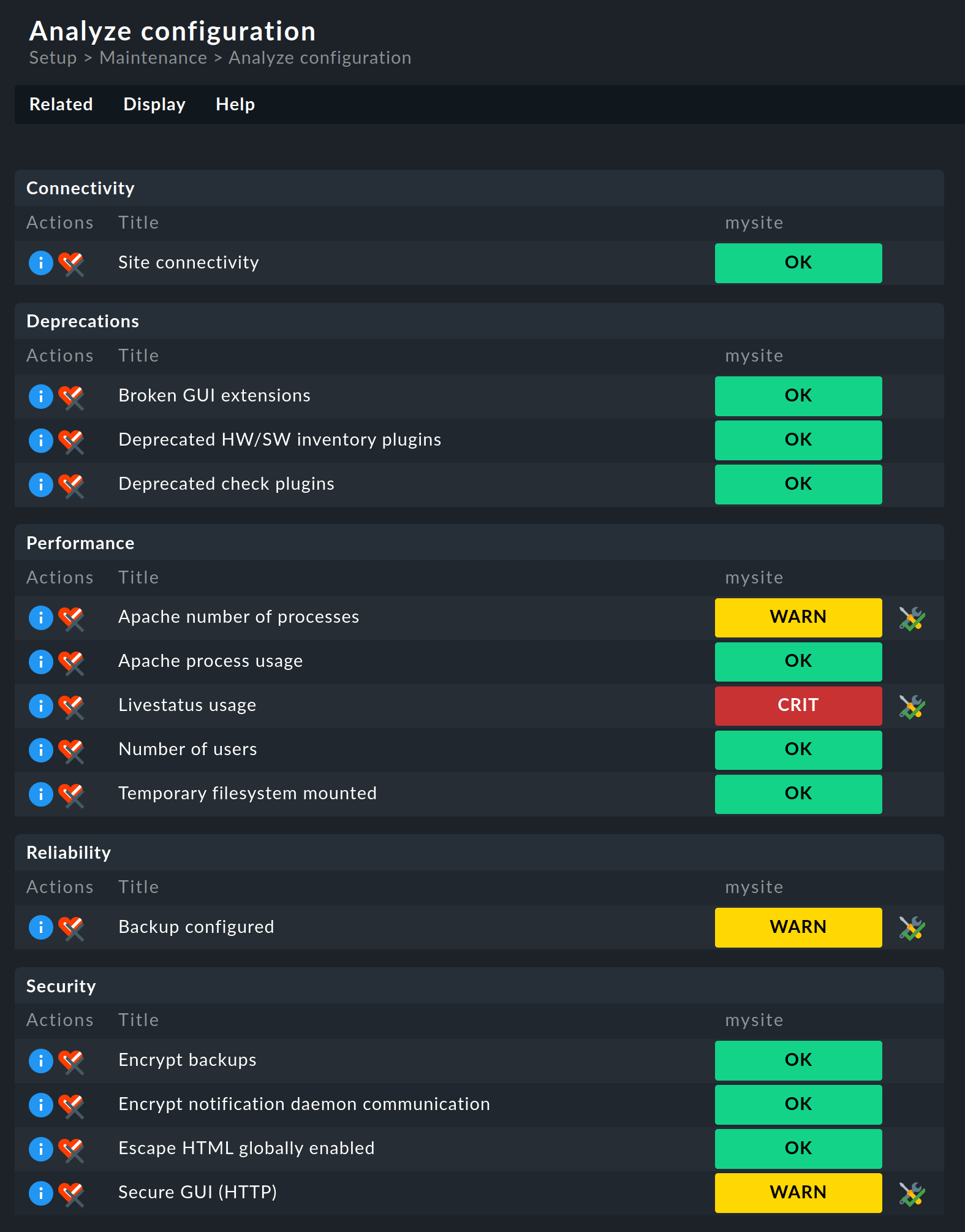

Checkmk quickly and clearly analyzes the essential parameters associated with the current site as well as any attached sites in the case of a distributed monitoring.
The hosts and services within your site(s) are not affected by these checks, they are still shown in the views of hosts and services. The results of the checks for the site covered here are displayed on the Setup > Maintenance > Analyze configuration page.
When Analyze configuration is called, the current state of all checks is always assessed and displayed. Therefore, after calling the menu item it may take a little while before the page with the results is displayed:
“Result from the ‘Analyze configuration’.”
The standard checks in Checkmk Community
The above screenshot shows the checks that are executed by default for a single site in Checkmk Community. However, this is not the whole story, as more checks may well be offered. What these are depends, for example, on whether you have installed Checkmk Community or one of the commercial editions, whether your site is used in a distributed monitoring, whether a specific rule has been set up, an LDAP connection exists, a global setting has been defined — or even the value of an option in a rule. Which check is relevant for your site — Checkmk takes care of that.

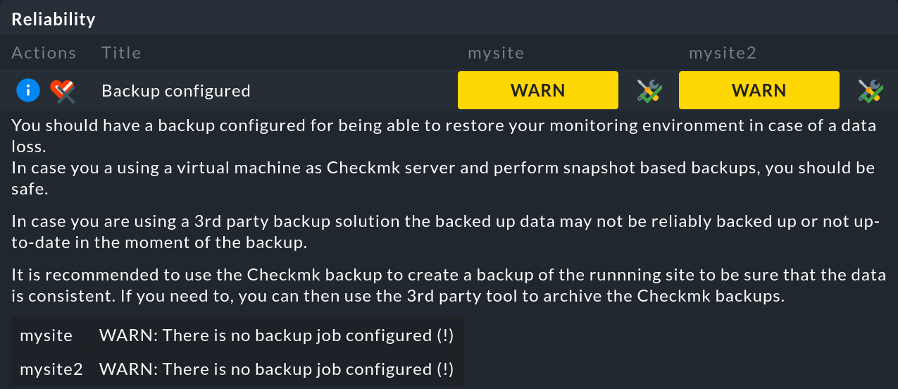

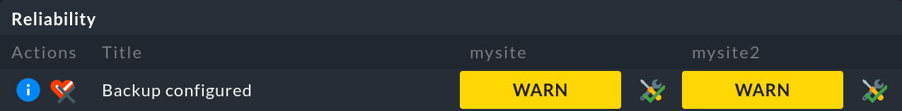

Let’s consider the Backup configured check with two sites in a distributed monitoring:
Section of the 'Backup configured' check.
This check is in a WARN state, so an Button to acknowledge the message. button appears after the WARN for acknowledging this. This button also appears for checks in the CRIT state. Acknowledgment causes the yellow or red color of the state to disappear. The entry itself remains, but becomes visually more discreet. If the check is acknowledged, the button changes to Button to cancel the acknowledgment.. This button can be used to cancel the acknowledgment.
In general, it makes sense to check the system environment for all parameters. However, if you do not want to run individual checks (again), you can disable any of the checks by clicking on the associated Button to disable a test. button. For example, turn off the Backup configured check if your organization uses a different solution for backup creation.

For each check, clicking on the associated Show more information button. button will give you more details on the detected values, an assessment of the status, as well as hints for optimization.
Detailed view of 'Backup configured'.
