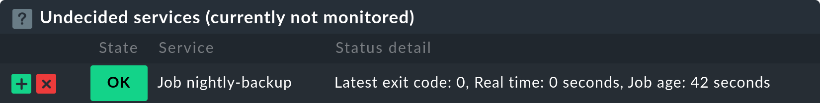

3. Adding the service to Checkmk
In Checkmk you will automatically find the service once the job has been executed and the results saved accordingly. So, as usual, go to the service discovery and activate the service:
discover mkjob

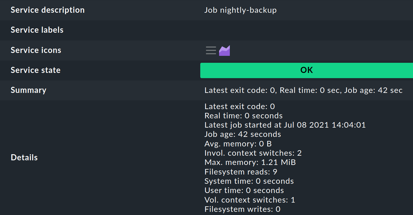

On the one hand, you will find all of the measurement points shown above as metrics and in predefined time series graphs. On the other hand, you will also find the measuring points in the summary and in the details for the service:
service mkjob
