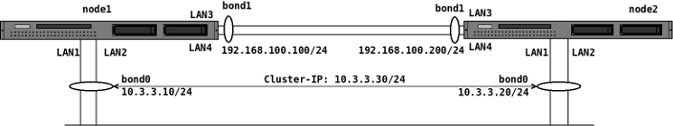

The following describes a reference configuration of a cluster with two bonding interfaces, which corresponds to the following diagram:
The interface designations LAN1, LAN2 etc. used in the diagram represent the physical interfaces on the device. The actual designations depend on the respective hardware.
The IP addresses used are of course arbitrary. However, make sure that the internal cluster network (bond1 in the diagram) uses a different IP network than the 'external' network (bond0 in the diagram).

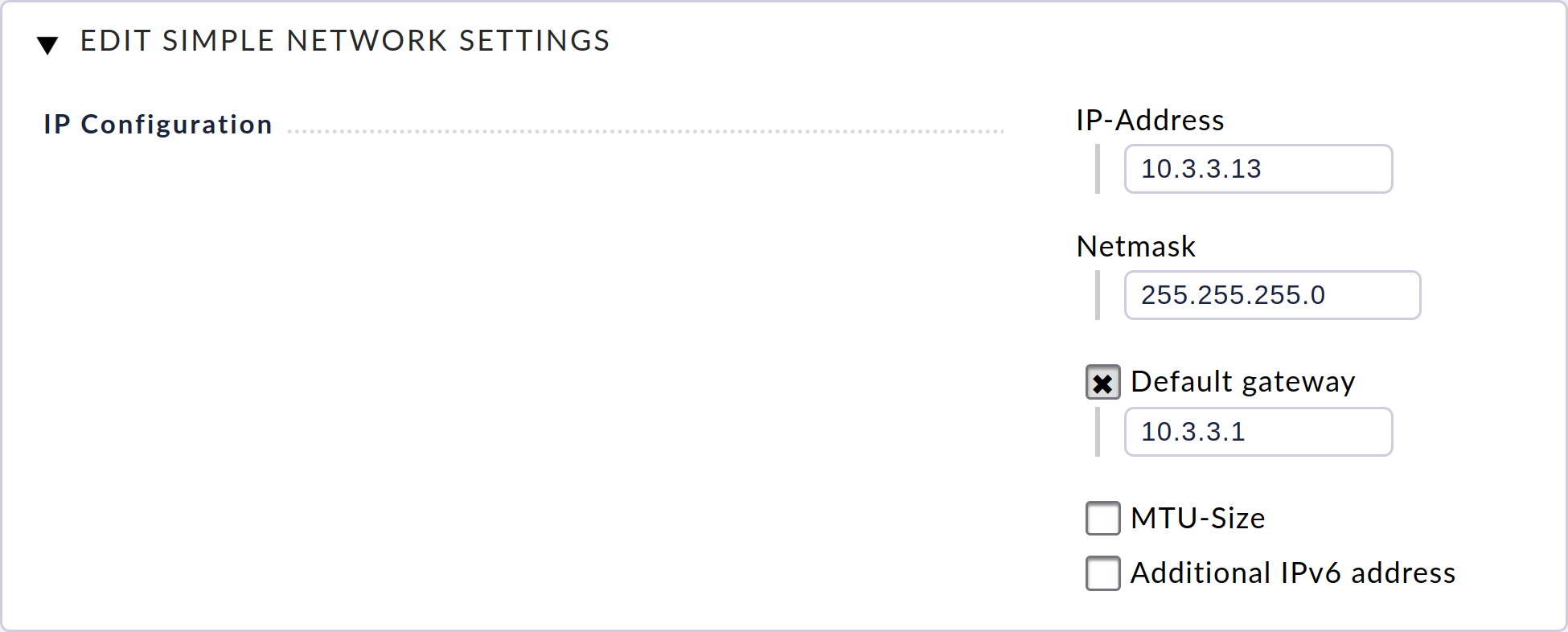

The Simple Mode, with which you can only configure your device’s standard interface, is activated by default. (This mode corresponds to the configuration via the text console that you performed during the initial setting up of the appliance).

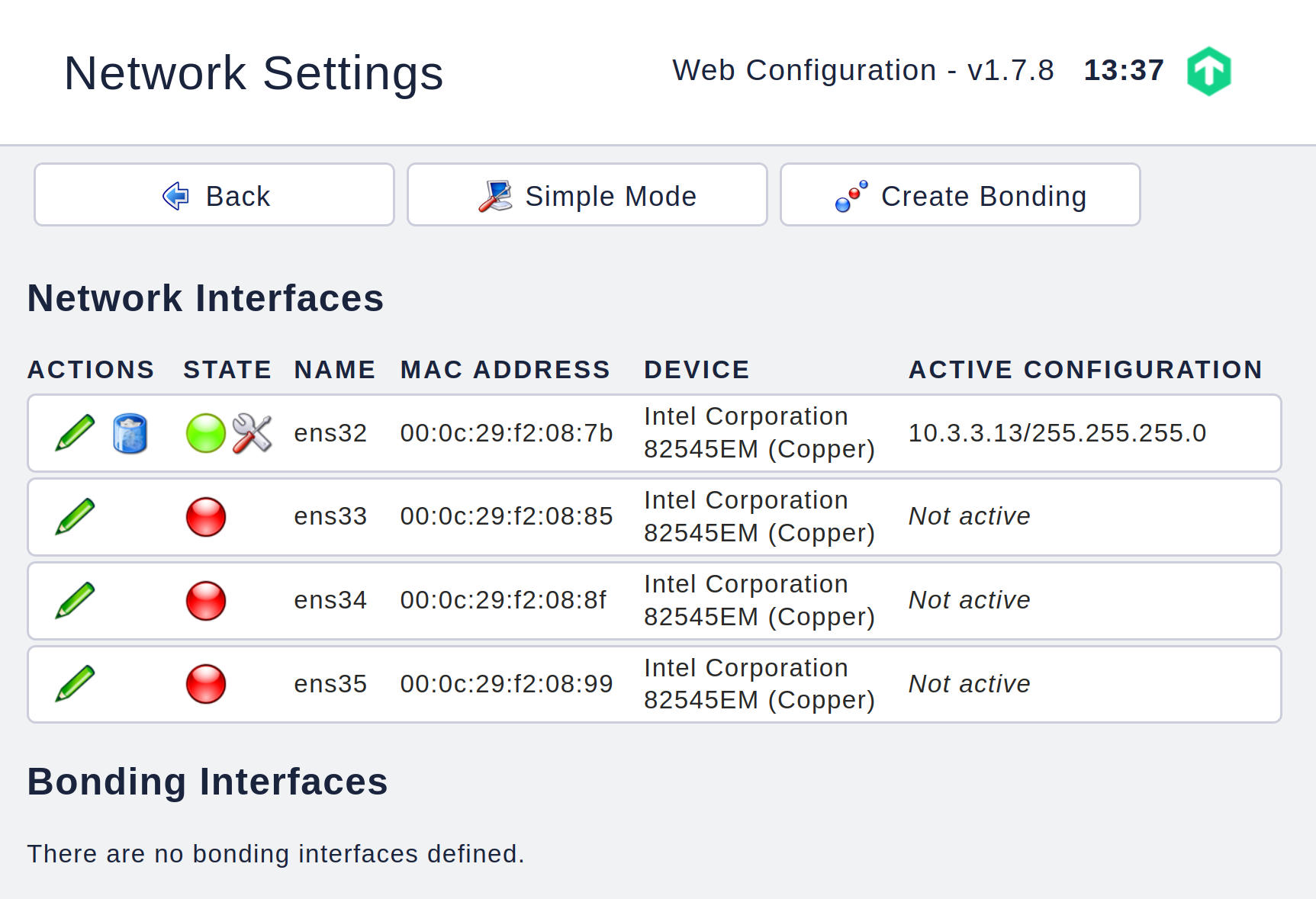

The advanced mode is required for clustering. To activate this mode, click on the Advanced Mode button at the top and approve the confirmation dialog.
On the following page you will see all of the network interfaces available in the unit. Only the standard interface currently has a configuration — here ens32 in the below screenshot. This was taken over from the Simple mode.

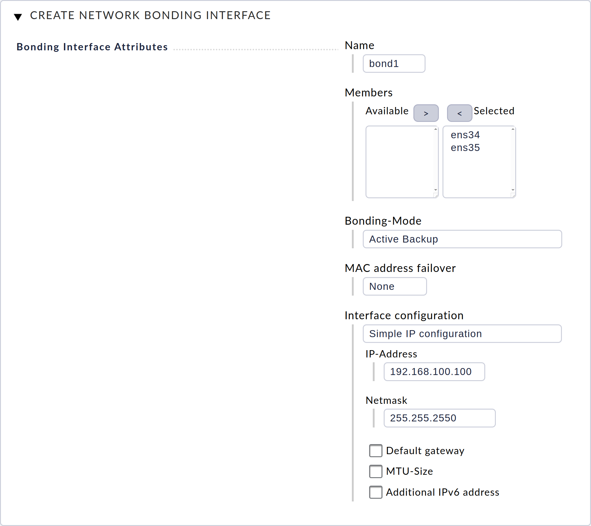

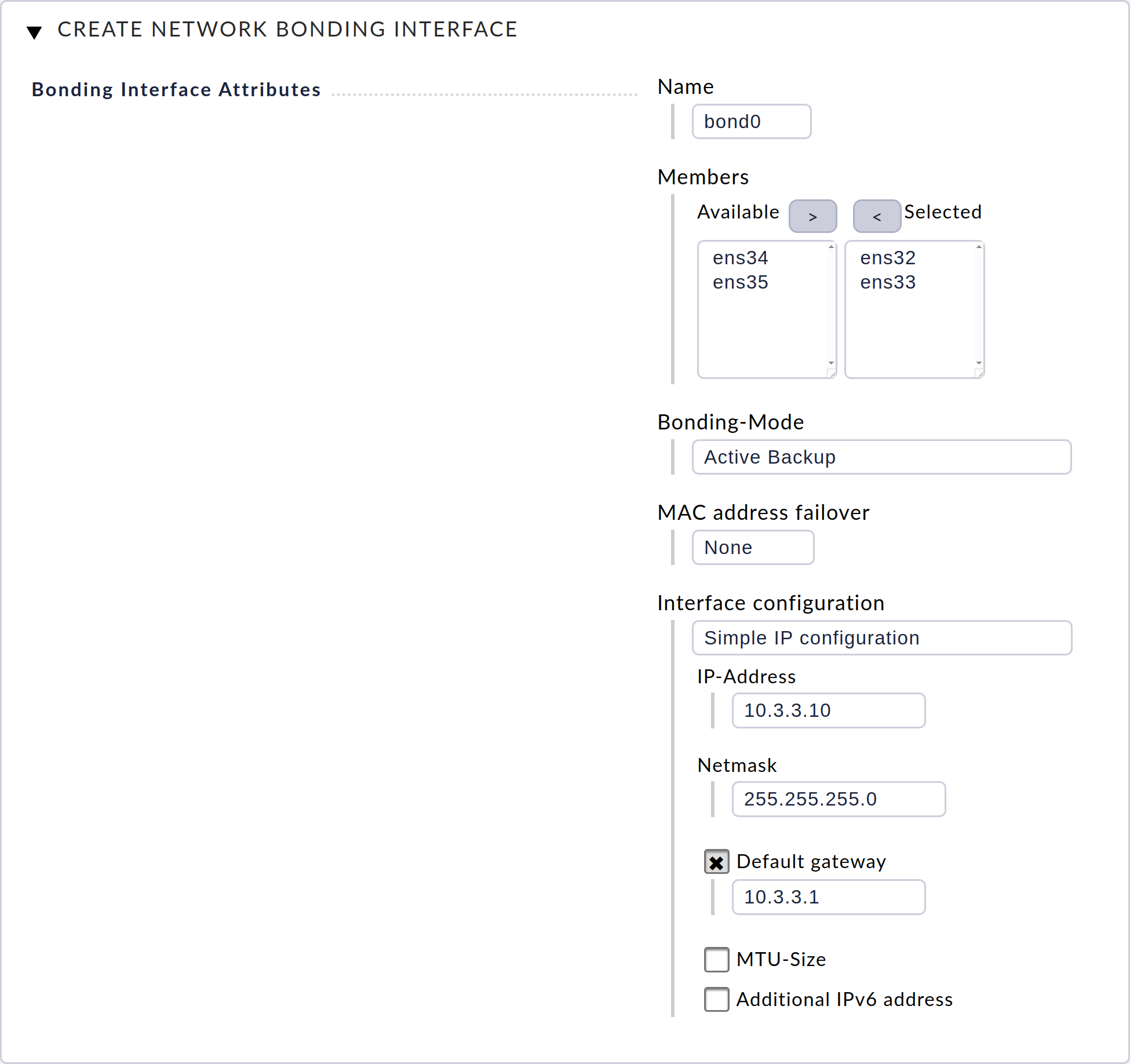

Now create the first bonding interface bond0 by clicking on Create Bonding. In the following dialog, enter all data as shown in the following screenshot and confirm the dialog with Save.
Next create the second bonding interface bond1 with the appropriate configuration for the direct sync connection.

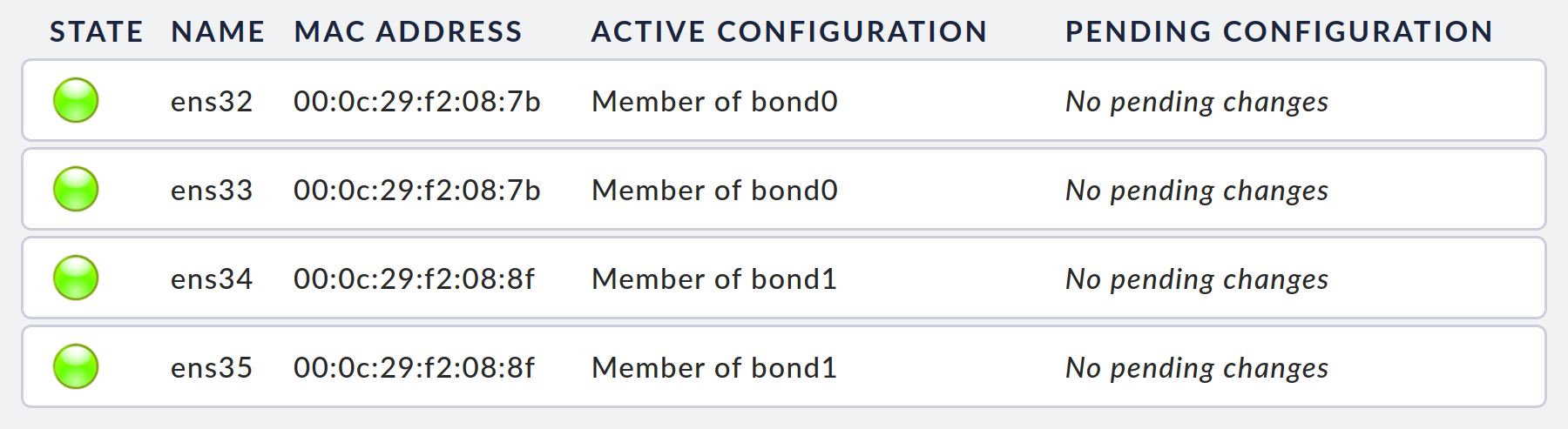

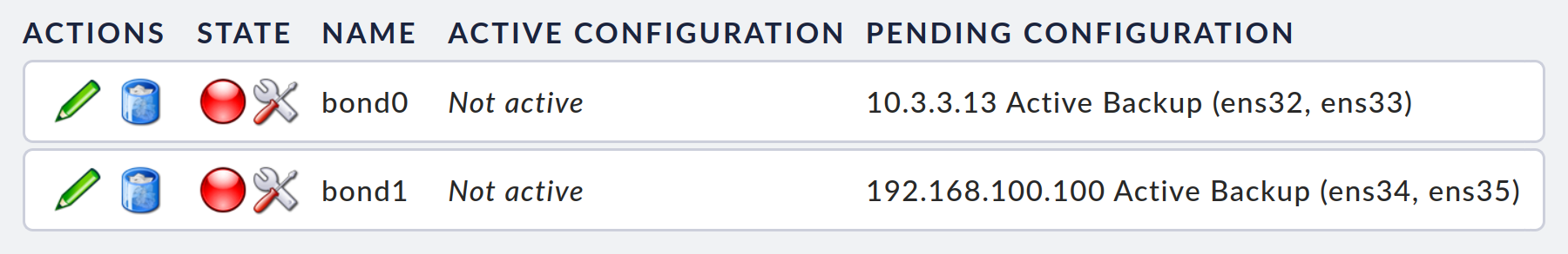

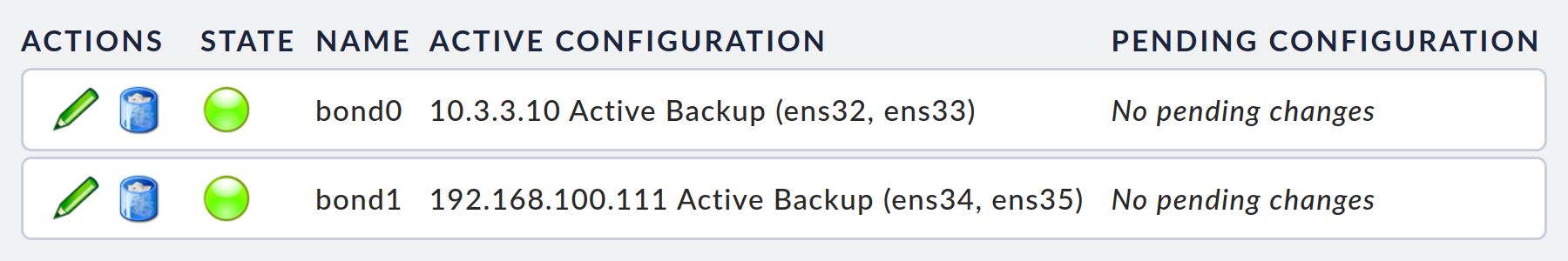

After you have created the two bonding interfaces, you will once again see all of the settings made in the network configuration dialog for the network interfaces …
… and for the bondings that have been created:
When you have successfully completed all of the configuration steps, click on Activate Changes to make the settings effective. The new network settings will then be loaded. After a few seconds the network configuration will show the status 'OK' everywhere, for the real network interfaces …
… and again at the bondings:

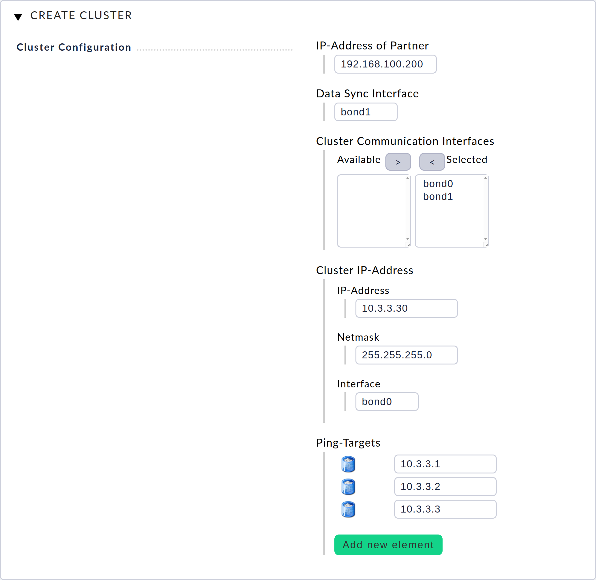

To do this, open the Clustering module on the web interface in the main menu of the first device (here cma1) and there click on Create Cluster.
In the dialog for creating the cluster, enter the corresponding configuration and confirm the dialog with Save. The Cluster IP address, which you will use later to access the cluster, is particularly important here. If you need further information on this dialog, call up the inline help via the icon next to the Checkmk logo.

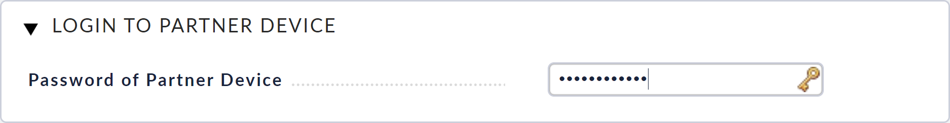

On the following page, you can connect the two devices to a cluster. To do this, you must enter the password for the second device’s web interface. This password is used once to establish the connection between the two units. Approve the confirmation dialog if you are sure that you want to overwrite the data on the displayed target device.
Once this connection has been successfully established, synchronization of the cluster’s devices will begin. You can view the current status of this process on the cluster page. During the synchronization, all resources, including any existing monitoring sites, will be started on the first node.

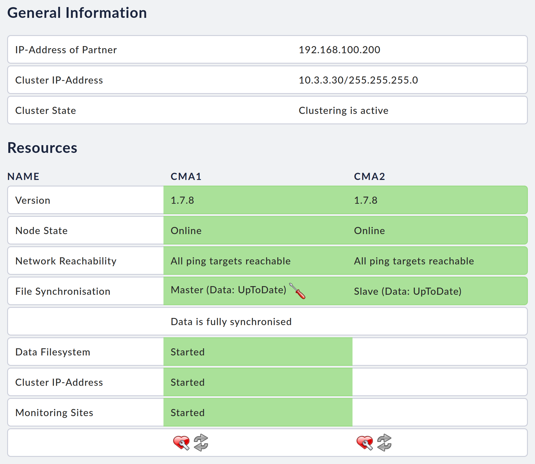

4. Status of the cluster

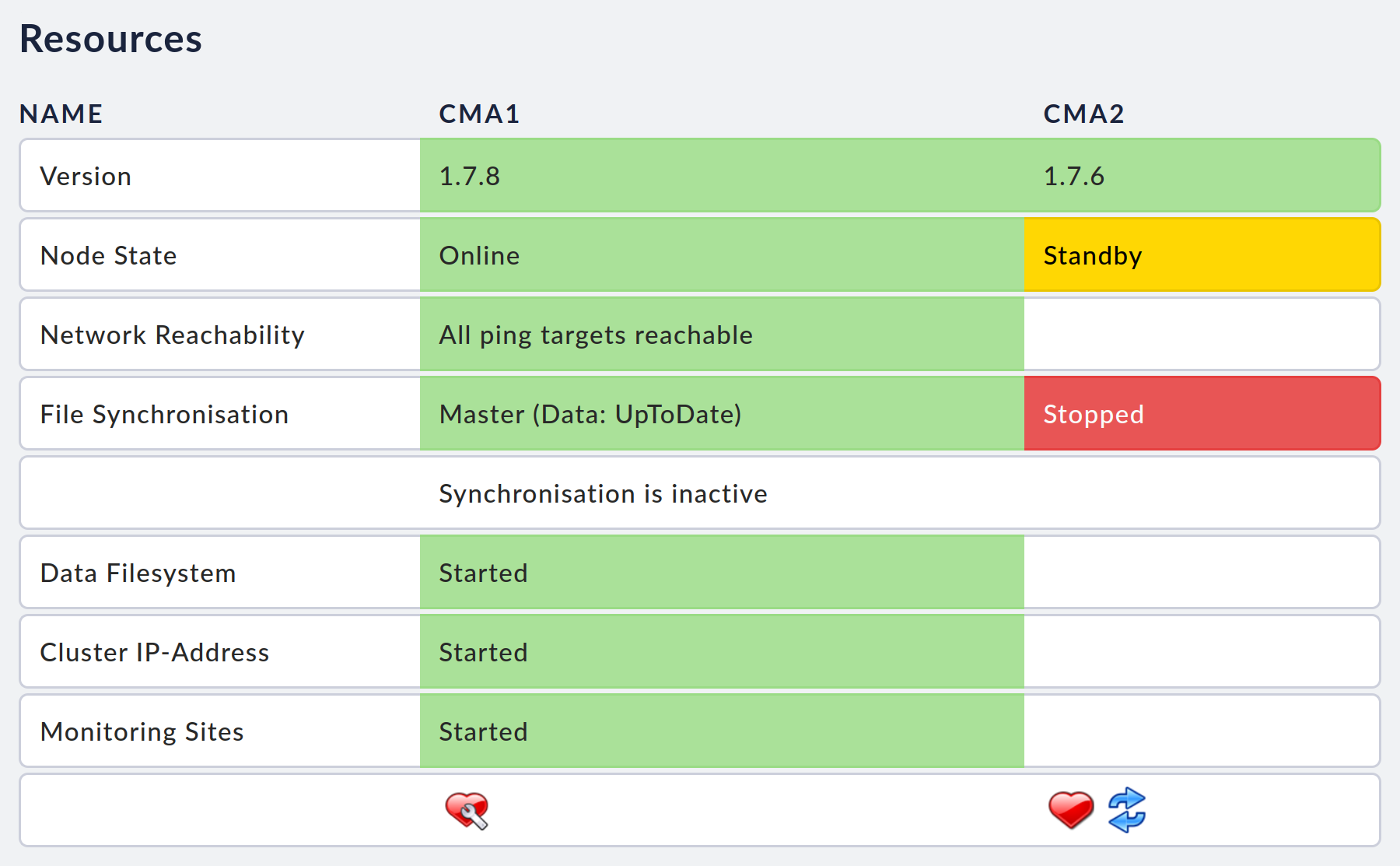

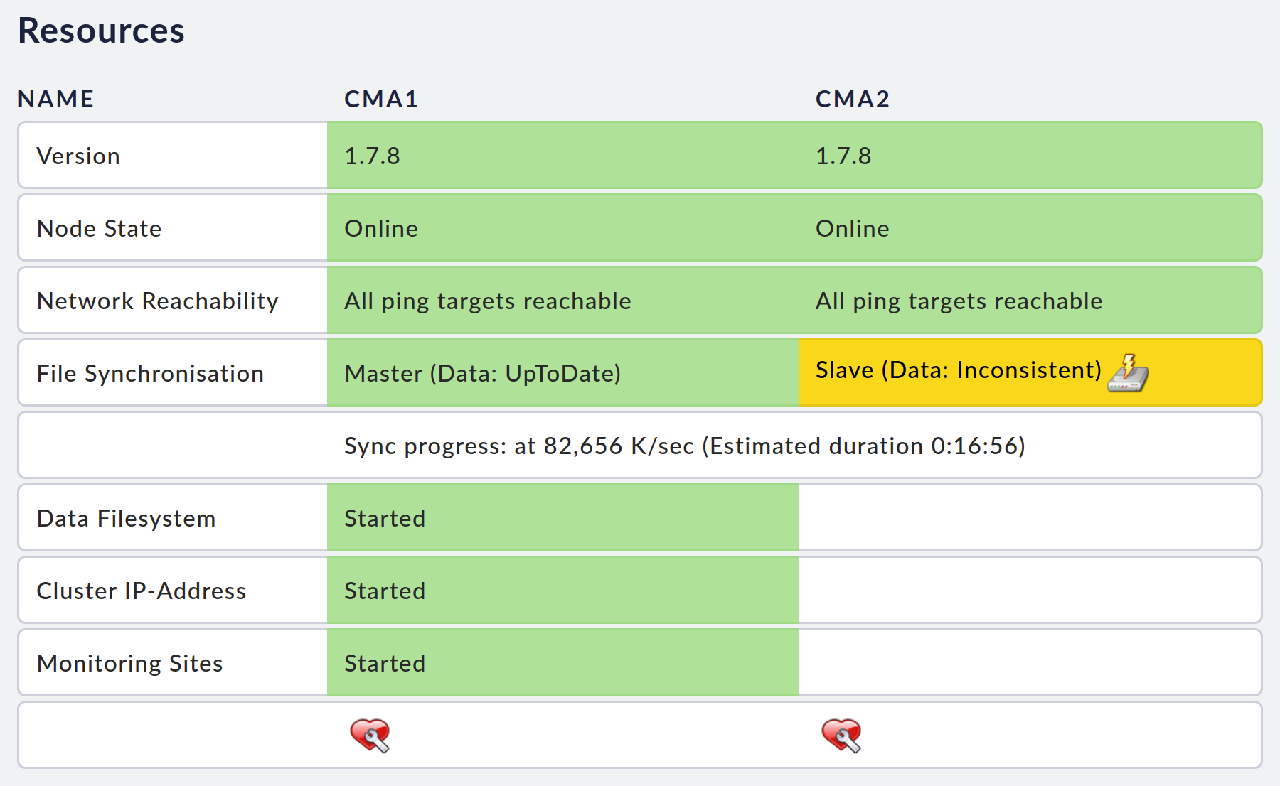

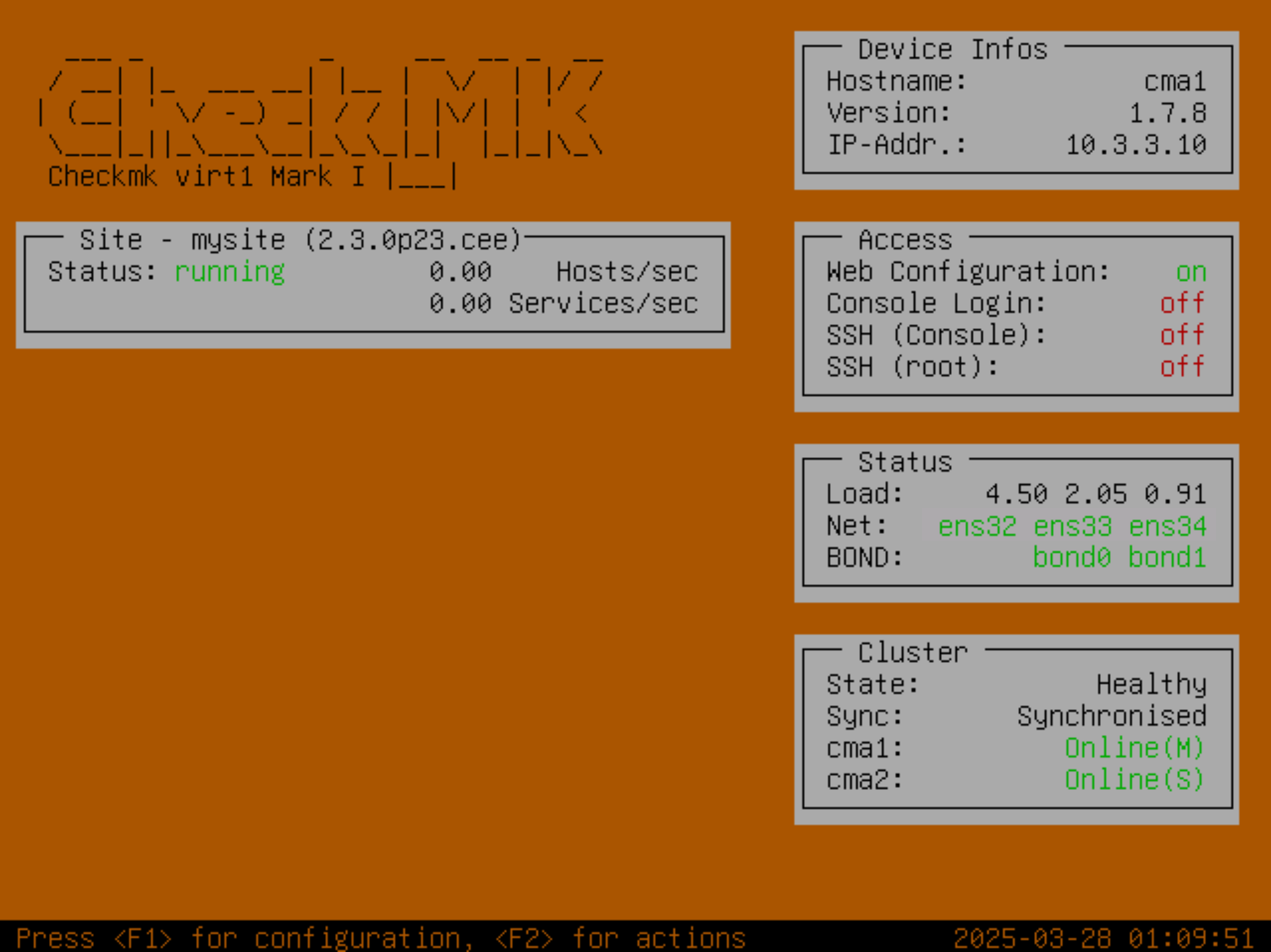

After the first synchronization has been completed, your cluster will be fully operational. You can view its status at any time on the cluster page.
With the help of the console’s status view, you can also see the current state of the cluster in a summarized form in the Cluster box. The role for each respective node is displayed in brackets after the current status: for the active node M (for Main) and for the passive node S (for Subordinate).

Now click on the 'heart' icon in this node’s column and approve the confirmation dialog that follows. This sets the node to maintenance state.
Nodes in maintenance state release all resources that are currently active on the node, and the other node will take them over.
While a node is in the maintenance state, the cluster is not fail-safe. If the active node is switched off, the inactive node, which is in the maintenance state, does not take over the resources. If you now also put the second node into the maintenance state, all resources will be shut down. These resources will only be reactivated when a node is brought out of the maintenance state. You must always remove the maintenance state manually.
If the cluster page shows the following, you will see that the node is in the maintenance state:

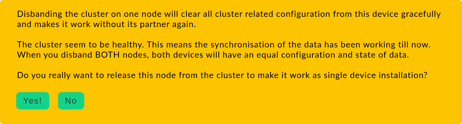

To dissolve a cluster, click Disband Cluster on the web interface’s cluster page. Note the text of the following confirmation dialog. In all the possible situations, this will tell you what state the respective device will be in after the connection has been terminated.
The separation of the appliances must be carried out separately on both nodes so that both appliances can be operated individually in the future.
If you want to use only one of the devices in the future, detach the cluster on the device that you want to continue using and then restore the factory state on the other device.
After you have disconnected a node from the cluster, the monitoring sites are not restarted automatically. You must do this manually afterwards if necessary.
