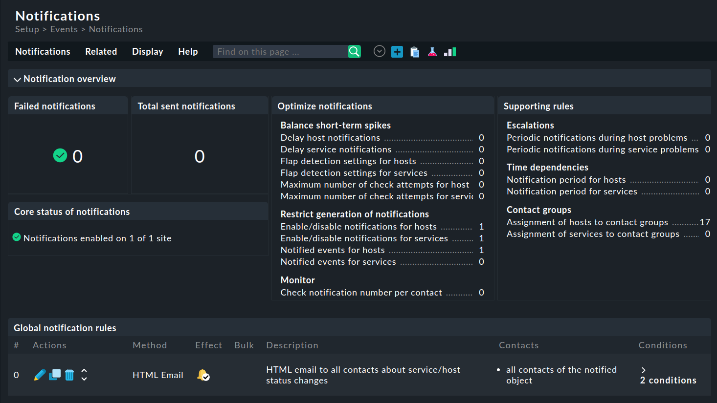

Via Setup > Events > Notification you can access the notifications overview page. All important information on this topic is bundled here:
“The notifications overview page.”
A functioning notification system is based on the interaction of a number of components that all need to be configured. This overview page saves you having to search for the individual rules, parameters etc. in the various areas of Checkmk. You can access all aspects relating to the topic of notifications from here.

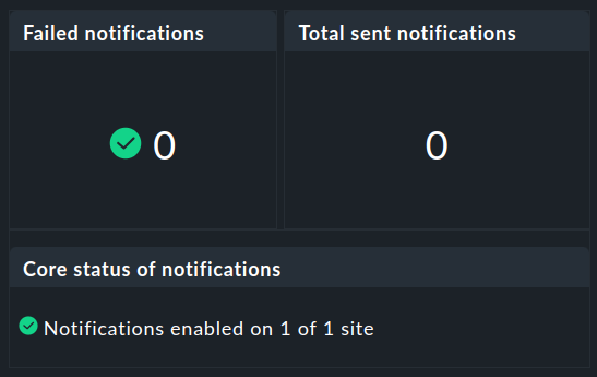

2.1. Status of the notifications
An overview of the current status of the notifications appears on the left-hand side of the page:
Overview of the current status of notifications.
Displayed are:

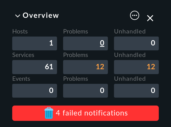

Failed notifications
Number of failed notifications. If failed notifications exist, a link to the corresponding overview is displayed below.
Total sent notifications
Number of notifications sent. If failed notifications exist, a link to the Notifications of host & services, filtered for the last 7 days, is displayed below. You can use this to take a closer look at which notifications have been sent.
Core status of notifications
Displays on how many Checkmk sites notifications are activated. If they are deactivated on a site, e.g. via the Master control snap-in, the site name is displayed. This allows you to check whether this was intended.
2.2. Notification rules
To the right of the status displays you will find links to all of the existing notification rules in Checkmk:
Listing of notification rules.
From here, you can access the rules for optimizing your notifications as well as all other rules relating to notifications.
The rules displayed here may already be familiar to you from other places in Checkmk. No new rules have been created here, only the existing ones have been clearly summarized.
2.3. Global and predefined notification rule
The last part of the overview page consists of the existing global rule.
If you have a freshly-installed Checkmk, precisely one rule will have been predefined:
List with the predefined notification rule.

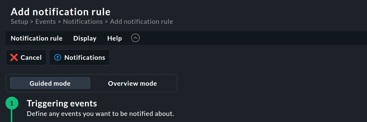

To make it easier to create rules for notifications, Checkmk looks different here compared to what you are used to in other areas. With Setup > Events > Notifications > Add notification rule you can get started with the creation of notifications:
“View of the two modes in ‘Add notification rule’.”
You will now need to make a decision.
If you select Guided mode, you will be guided, section by section, through the creation of a notification rule. Each section deals specifically with one aspect of the notification. Fill in the respective section with the data relevant to your environment. Descriptions of the individual topics can be found later in this article. Once you have edited a section, click on Next step…​. Your details will then be verified, provided they are technically mandatory. If, for example, technically relevant data such as the email address to be used is missing, you will receive an error message. Once you have entered the essential basic data correctly, you will be taken to the next section and then finally to the end where you will have prepared a complete notification rule. Then complete the creation with either Apply & test notification rule or Apply & create another rule.
Alternatively, you can use the Overview mode. This is particularly useful for the targeted editing of individual parameters in an existing notification rule — likewise if you are already very familiar with rule creation and no longer want to be guided. In Overview mode you see all editing sections at the same time and can edit all fields and options directly. The technical verification is then carried out once and across all sections as soon as you click on Apply & test notification rule or Apply & create another rule.

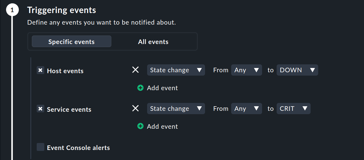

Defining event types
In the following example of the structure of a notification rule, two status changes should trigger notifications:
  • Hosts that change to the DOWN state and
  • Services that change to the CRIT state.
This is defined in step 1:
“Rule with extended conditions for creating a notification.”

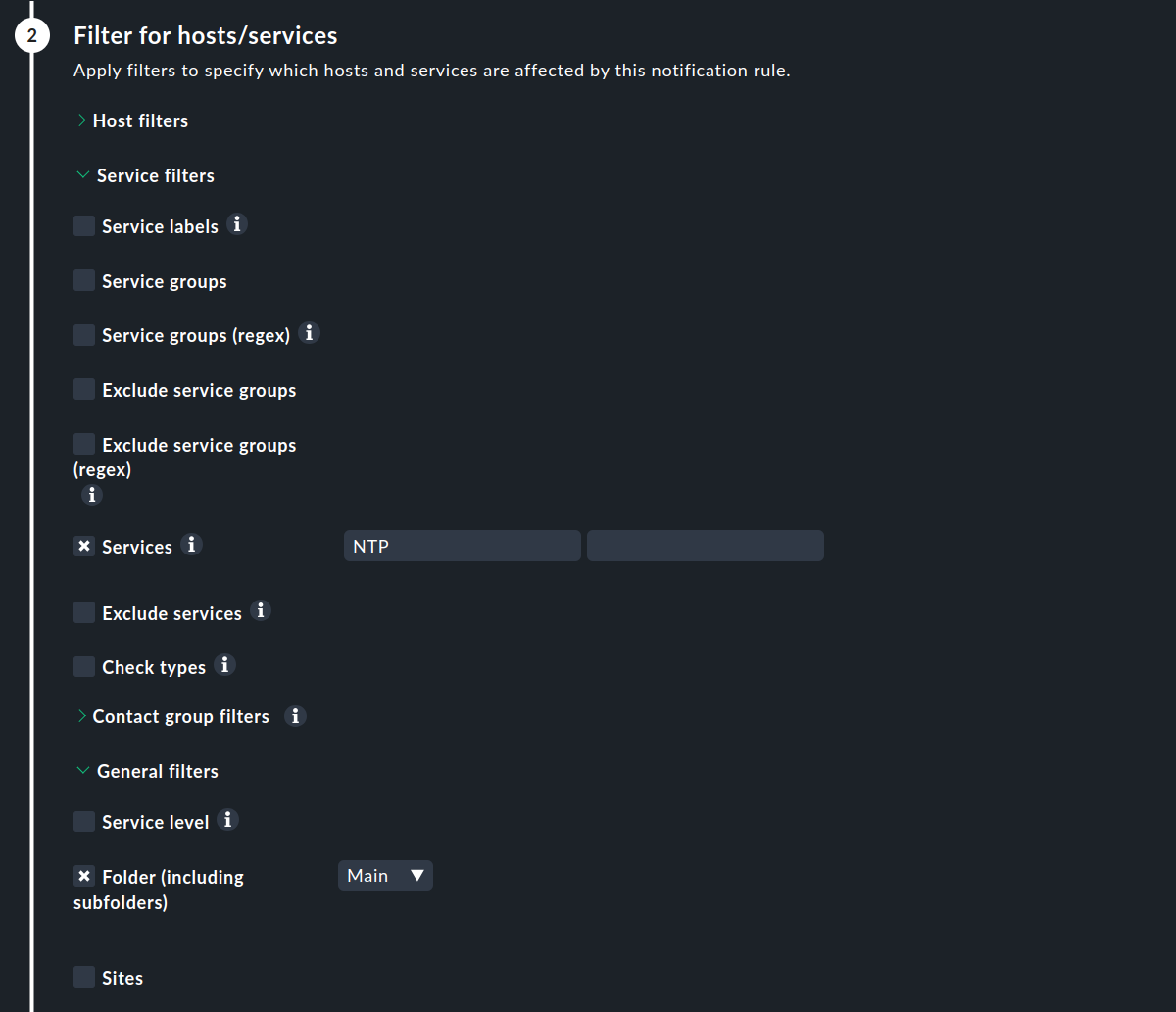

Setting host and service filters
In step 2, you use various filters to determine the hosts and services to which the notification rule should apply.
Assume you were to set the filter so that a notification would only be sent if a monitoring event for a service starting with the name NTP occurred on a host in the Main folder:
“Rule with the conditions for creating a notification.”
The result of this notification rule with the three individual conditions (status changes, service name, folder) would be that the notifications would only be sent if a service went to CRIT — and the status changes of the host would be ignored because no monitoring event would contain the status change of a host and the service name with NTP.
A further tip regarding the Contact group filters option in the image above: The condition checked here is whether the host/service in question has a certain contact assignment. This can be used to implement functions such as "Host notifications in the contact group Linux should never be sent by SMS". This has nothing to do with the contact selection described above.

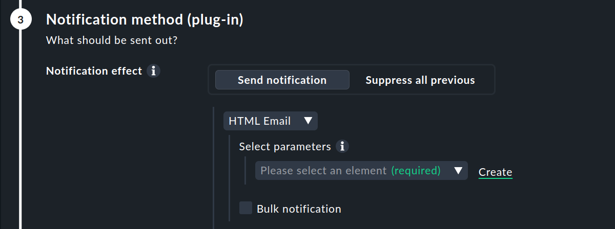

Notification method

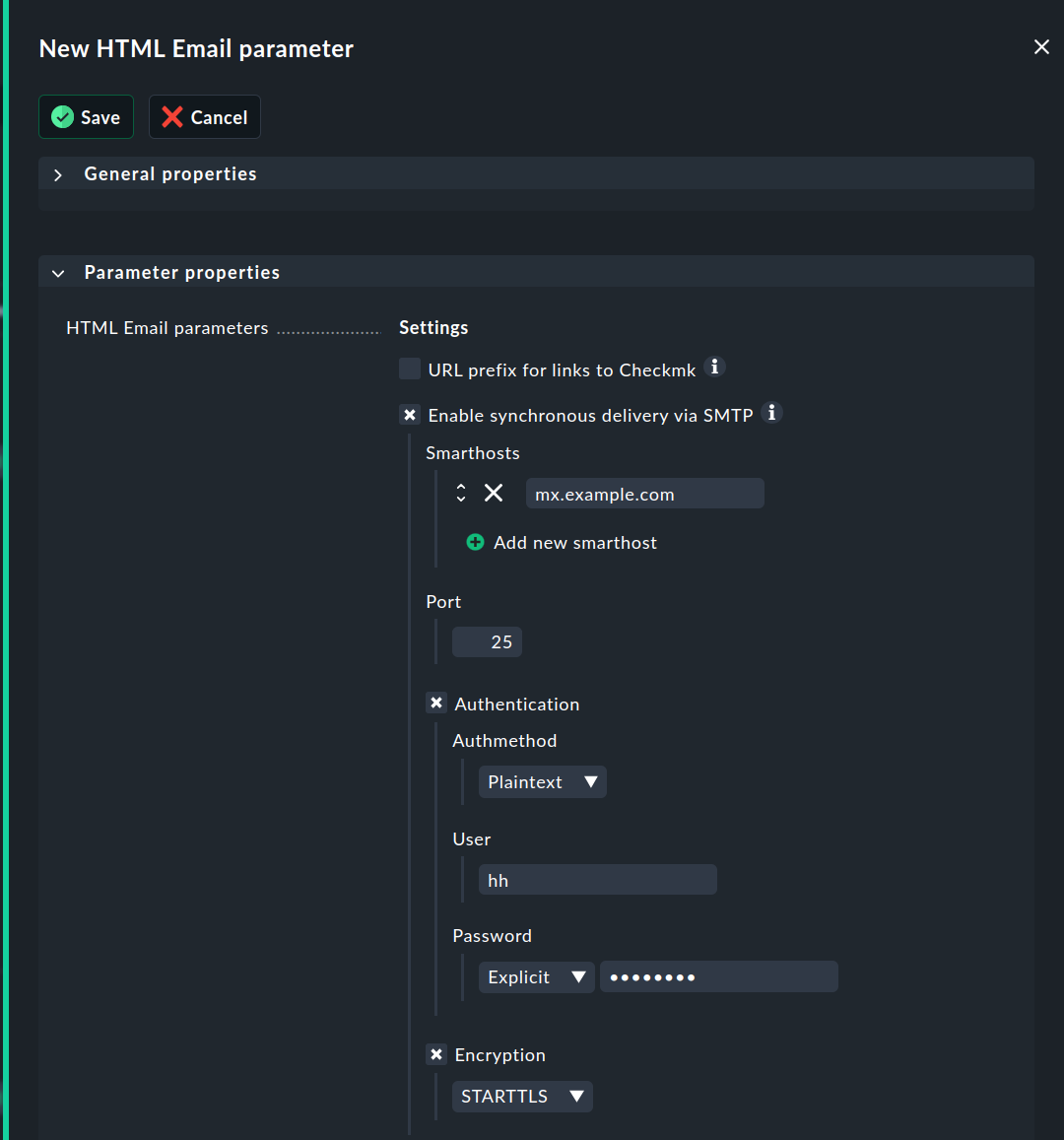

The notification method in step 3 specifies the technique to be used for sending the notification., e.g. with HTML email.
Regel mit den Optionen zur Benachrichtigungsmethode.
Each method is realized using a script. Checkmk includes a number of predefined scripts. You can also quite easily write your own custom scripts in any desired programming language in order to implement special notifications — for example, to redirect a notification to your own ticket system.
Some notification methods can include parameters. For example, the methods for ASCII and HTML emails allow you to explicitly specify the sender address (From:). The appropriate page for setting the parameters appears after selecting the method as soon as you click on Create.
However, before you make settings in the individual notification rule here, you should know that you can also set parameters for the notification methods generally in two other places in Checkmk:
  • In the Parameters for notification methods, which are described later in this article. In the notification rule, select the desired parameter definition under Select parameters before you click on Create to change the selected parameter definition for this notification rule.
  • In the rules for hosts and services: Under Setup > Services > Service monitoring rules, you will find a rule set for each notification method in the Notifications section, which you can use to define the same settings — and as usual, depending on the host or service.
Only change the parameter definitions in the notification rule if you want to deviate from these settings for individual cases. For example, you can define a specific subject for your email globally, but define an alternative subject in an individual notification rule.
Instead of Send notification, you can also select Suppress all previous. Notifications from previous rules that used this method will then be discarded. You can find more information on this in the section Deleting notifications by rules.

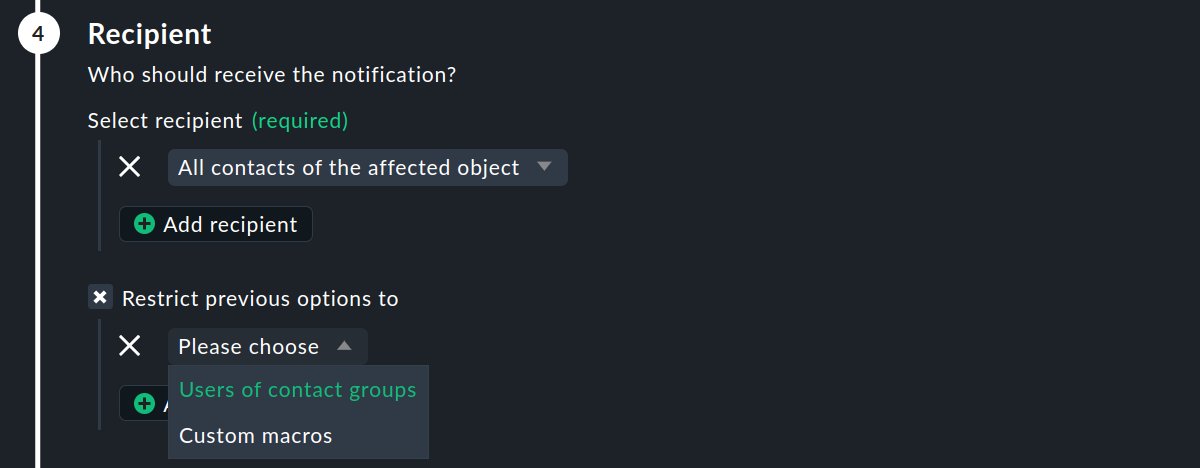

Selecting contacts
The most common procedure is for notifications to be sent to all users who have been registered as a contact for the respective host/service. This is the ‘normal’ and logical procedure, since it is also via the contacts that it is defined which objects each user receives in their GUI display — in effect those objects for which the user is responsible.
You can specify several options when selecting contacts with Add recipient and thus extend the notification to more contacts. Checkmk will automatically delete duplicate contacts. In order for the rule to make sense at least one selection must be made.
Rule with contact selection options.
The two Restrict previous options to options function somewhat differently. Here the contacts selected with the other options will again be restricted. With these you can also create an AND-operator between contact groups, for example, to enable notifications to be sent to all contacts who are members of both the Linux and Data center groups.

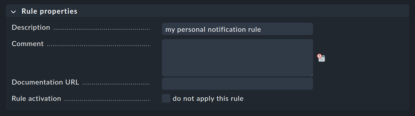

General properties
As with all rules in Checkmk, here you can include a description and a commentary for the rule, or even temporarily deactivate the rule.
Rule with the option to enable disabling of notifications by users.
With the Allow users to deactivate this notification option you can allow users to 'unsubscribe' from notifications generated by this rule. We show how to do this with the personal notifications.

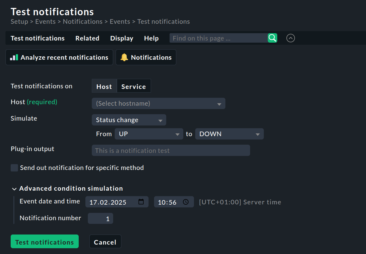

For testing notification rules, Checkmk offers a smart tool with Test notifications. You can use it to simulate a notification for a host or service and recognize which of your notification rules are effective. In addition to the simulation, you can also have the notification sent.
The quickest way to access the notification test is via Setup > Events > Test notifications. In addition, there are other options for calling from some views in Monitoring (service list and service details) and in the Setup (host properties), in each case in the menu Host > Test notifications.
Dialog for defining the properties of the simulated notification.
First, click on one of the two buttons to decide whether the notification is for a Host or a Service. Then select which host or service it should be. As the event you can select a state change or the start of a scheduled downtime. You can add a description of the event to Plugin output. Use the Send out notification for specific method checkbox to specify whether the notification is only simulated or actually sent.
Finally, under Advanced condition simulation there are two further options with which you can define the time and number of notifications. This allows you to test notification rules that only apply during a certain period (e.g. outside of business hours) or that start an escalation after a specified number of repeated notifications.
Click on Test notifications to start the test — and also the dispatch, if you have selected this option. The results are displayed below the Test notifications box:

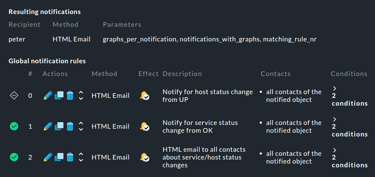

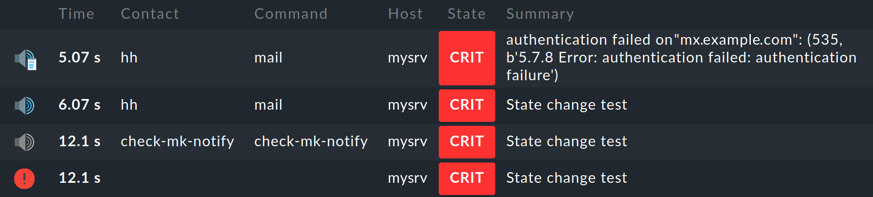

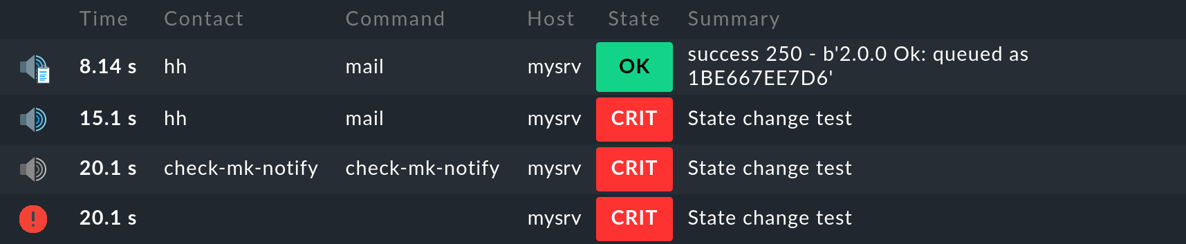

First comes the summary. Under Test results you can see how many notification rules apply and how many notifications result from them. If you have selected Send out notification, the corresponding message notifications have been sent out is displayed here. This must then immediately lead to an email for this problem.
The line below summarizes the notifications generated from your entries. By clicking on the Icon for showing or hiding the notification context. icon, you can show the notification context. This allows you to see the environment variables and their values that are valid in the context of this notification.
The following two sections then show more details:
The details of the simulation results.
Under Predicted notifications you can see to whom and how notifications would be sent. You will also receive this information about the simulation if you have not selected to send the notification.
Under Global notification rules the notification rules are listed that you have created here. At this point, only the first column of the table is important, which uses icons to indicate which of the rules apply Icon for displaying a positive status. and which do not Icon for displaying a negative status..

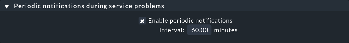

Set up periodically-repeated notifications
Checkmk can be set up so that successive notifications are issued at fixed intervals, until either the problem has been Icon of an acknowledgment. acknowledged or solved.
The setting for this can be found in the Periodic notifications during host problems, or respectively, the Periodic notifications during service problems rule set:
Rule for periodically-repeated notifications.
Once this option is active, for a persistent problem, Checkmk will trigger regular notifications at the configured intervals. These notifications will receive an incrementing number beginning with 1 (for the initial notification).
Periodic notifications are not only useful for reminding about a problem (and annoying the operator), they also provide a basis for escalations — meaning that after a defined time a notification can be escalated to other recipients.

As already mentioned in the selection of the notification method, you will also find the selection option Suppress all previous. In order to be able to understand the functioning of such a rule, it is best to visualize the notification table. Assuming the processing of the rules for a concrete monitoring event is partly complete, and that due to a number of rules the following three notifications have been triggered:
Who (contact) How (method)
Harry Hirsch
Email
Bruno Weizenkeim
Email
Bruno Weizenkeim
SMS
Now comes a next rule with the SMS method and the Suppress all previous selection. The contact selection chooses the 'Windows' group, in which Bruno Weizenkeim is a member. As a result of this rule, the entry 'Bruno Weizenkeim / SMS' is removed from the table, which then looks like this:
Harry Hirsch
Email
Bruno Weizenkeim
Email
Should a subsequent rule again define an SMS notification for Bruno, then this rule will have priority and the SMS will be added anew to the table.
To summarize:
  • Rules can suppress (delete) specific notifications.
  • Deletion rules must come after the rules that create the notifications.
  • A deletion rule does not actually ‘delete’ a preceding rule, rather it suppresses the notifications that are generated by (possibly multiple) preceding rules.
  • Subsequent rules can reinstate the previously suppressed notifications.
4.7. Synchronous delivery for HTML emails
You can select and configure the traceable delivery via SMTP for the notification method HTML email by entering the smarthost (with name and port number) and the access data and encryption method:
Notification method with synchronous email delivery options.
In the history of the service concerned, you can then track the delivery exactly. Here is an example in which a service — for testing purposes — was manually set to CRIT. The screenshot below shows the notifications for this service, which you can display on the service details page with Service > Service Notifications:
List of accumulated notifications for a successful email delivery.
Here you will see the four individual steps in the chronological sequence from bottom to top, as we have already presented them in the chapter on notification history in the in article on the notification basics. The important difference is that now you can see in the icon alert notify result topmost entry that the email was successfully delivered to the smarthost and its response is success.
You can also follow the individual steps in the ~/var/log/notify.log file. The following lines belong to the last step and contain the response of the SMTP server:
2021-08-26 10:02:22,016 [20] [cmk.base.notify] Got spool file d3b417a5 (mysrv;CPU load) for local delivery via mail
2021-08-26 10:02:22,017 [20] [cmk.base.notify]      executing /omd/sites/mysite/share/check_mk/notifications/mail
2021-08-26 10:02:29,538 [20] [cmk.base.notify]      Output: success 250 - b'2.0.0 Ok: queued as 1BE667EE7D6'
The Message-ID 1BE667EE7D6 will appear in the smarthost’s log file. There — if you are concerned — you can investigate where the email has gotten to. In any case you can prove that, and when, the email was correctly sent from Checkmk.
Let us repeat the test from above, but this time with a falsely-configured password for the SMTP transfer to the smarthost. Here you can see in plain text the SMTP error message Error: authentication failed from the smarthost:
List of accumulated notifications for a failed email delivery.
What can be done about failed notifications? Again, notifying by email is apparently not a good solution. Instead Checkmk shows a clear warning with red background color in the Overview snap-in:
Display of failed notifications in the 'Overview' snap-in.
Here you can:
  • Click on the text …​ failed notifications for a list of the failed deliveries.
  • Click on the Icon for deleting. icon to confirm these messages and remove the notice by clicking on Icon for confirmation. Confirm in the overview that opens.

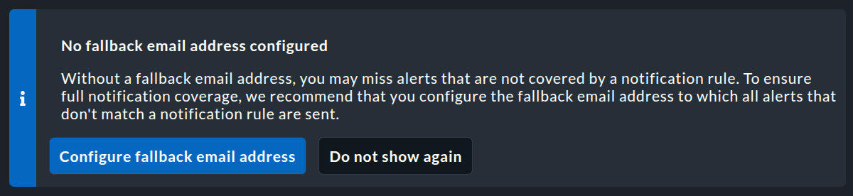

To protect you from such a case, Checkmk offers the setting Fallback email address for notifications. This can be found under Setup > General > Global settings in the Notifications section. Enter an email address here. This email address will then receive notifications for which no notification rule applies.
Alternatively, you can also make a user the recipient in his personal settings. The email address stored with the user is used as the fallback address.
The fallback address will however only be used if no rule applies, not when no notification has been triggered! As we showed in in the section on deletion of notifications, the explicit suppression of notifications is desired — it is not a configuration error.
The entry of a fallback address will be ‘recommended’ on the Notifications page with an onscreen warning:
Warning that no fallback email address is stored.
If — for whatever reason — you only want to get rid of the warning, but at the same time do not want to receive emails at the fallback address, first enter a fallback address anyhow and then create a new rule as the first rule, which deletes all previous notifications. This rule is ineffective on the notification configuration, as no notifications have been created here yet. But with this you can ensure that at least one rule will always apply, thus allowing this warning to be eliminated.
We explicitly advise against this approach, as you may overlook gaps in your rule chain.
