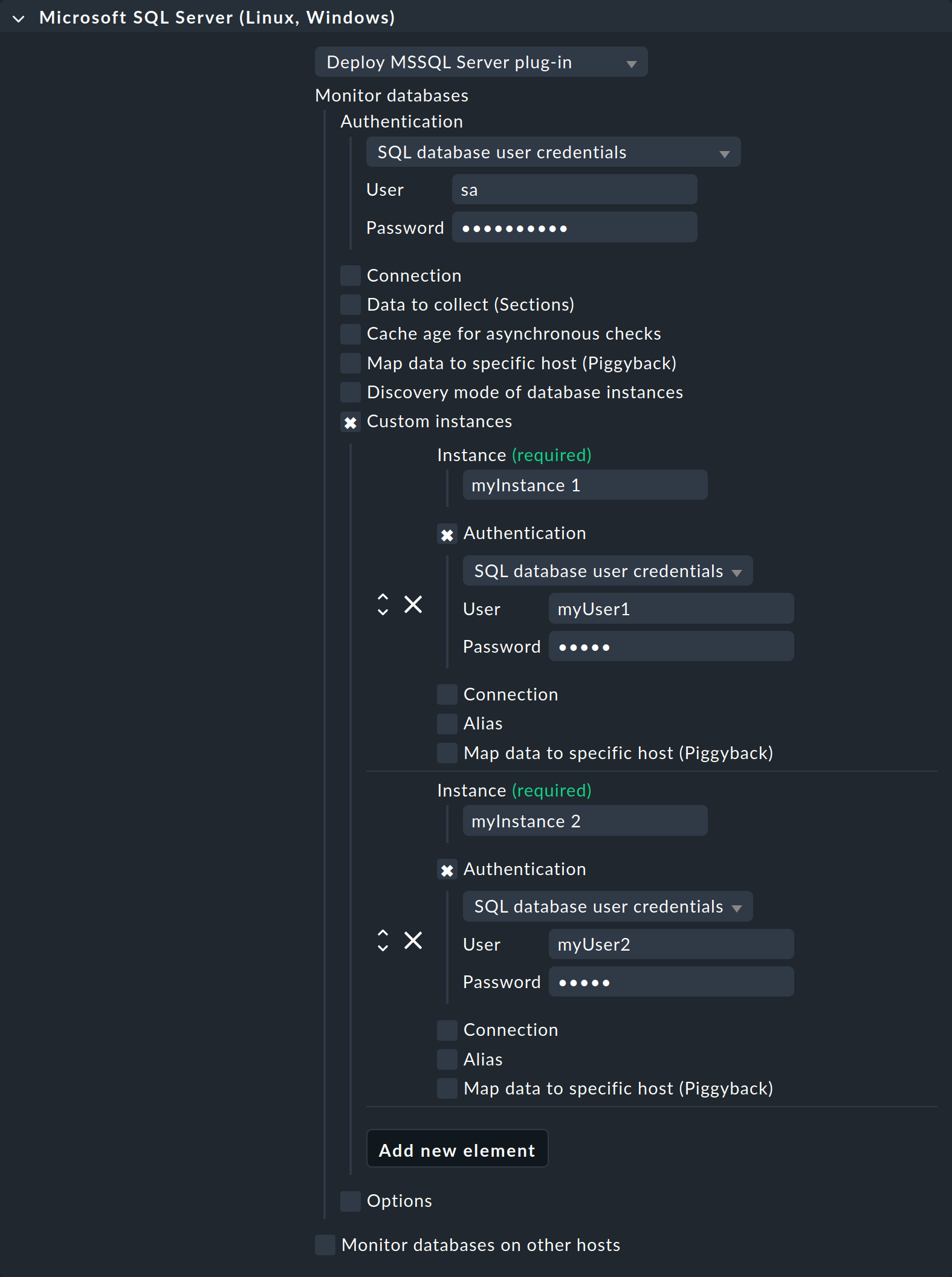

If you are running multiple MSSQL instances with different usernames and passwords on the host, select the Custom instances option. Use Add new element to access the details for the first—​and then each additional—​instance to be monitored. Enter the access data for each instance here, as described above.
Multiple MSSQL instances in the Agent Bakery rule.
