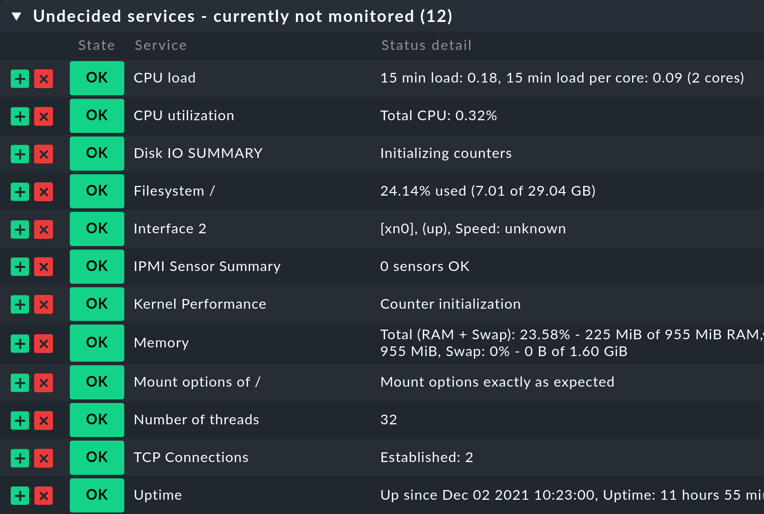

The inclusion into the monitoring is performed by an automatic service discovery, as with all other systems. For a 'bare' FreeBSD with no server services configured yet, at least 11 services should be discovered, and ten additional ones for file system information if installed on ZFS:
List of 12 automatically discovered services.
The service discovery in Checkmk will find at least 11 services.

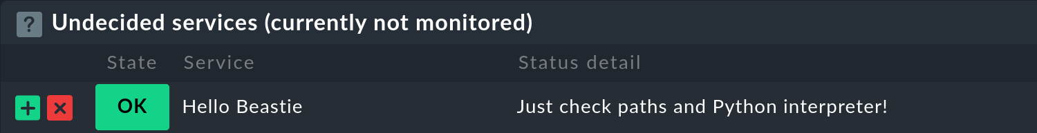

Also in this case the service is found immediately:
List with the newly detected service Hello Beastie.
The new service "Hello Beastie" was found
