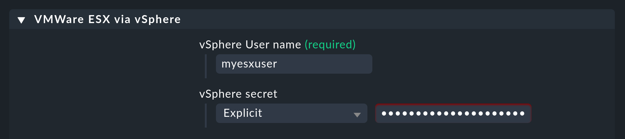

Once the prerequisites have have been satisfied you can create a rule in the Setup > VM, cloud, container > VMware ESX via vSphere rule set. This will be assigned to the defined host, so that instead of the standard agent the special agent will be used for retrieving data from the VMware-monitoring.
Enter the user’s name and password as they have been defined on the ESXi server. The condition for the rule must be set on the host defined in Checkmk. After this the first installation will be complete and Checkmk can retrieve the data from the server.

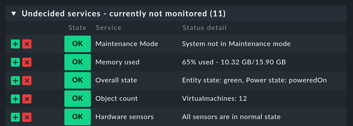

Finally, go back to the host configuration, and execute a service discovery. This should find a number of services:
vmware discovery
Activate the changes as usual. If no services have been identified, you can search for errors in the configuration with the Diagnostic options, as described later in this article.

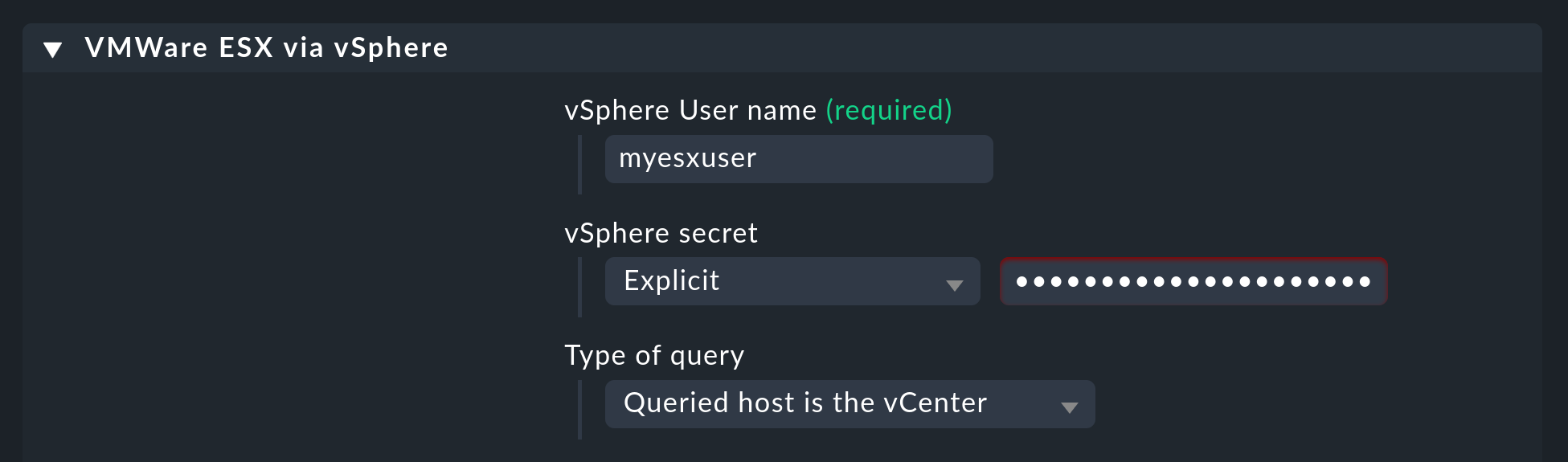

As described earlier, create a rule for the VMware-monitoring’s special agent, in Type of Query select the vCenter, and set the condition to the appropriate host as defined in Checkmk:
vmware vcenter username
With this the configuration will be completed. Execute a service discovery for the vCenter-host.

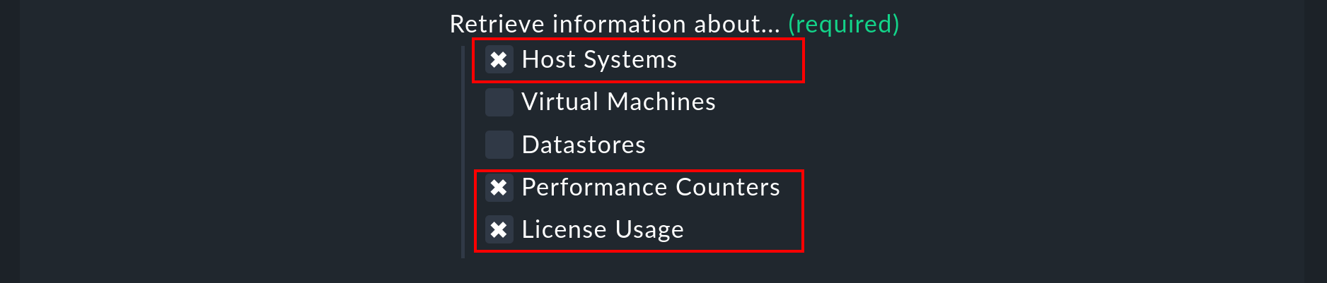

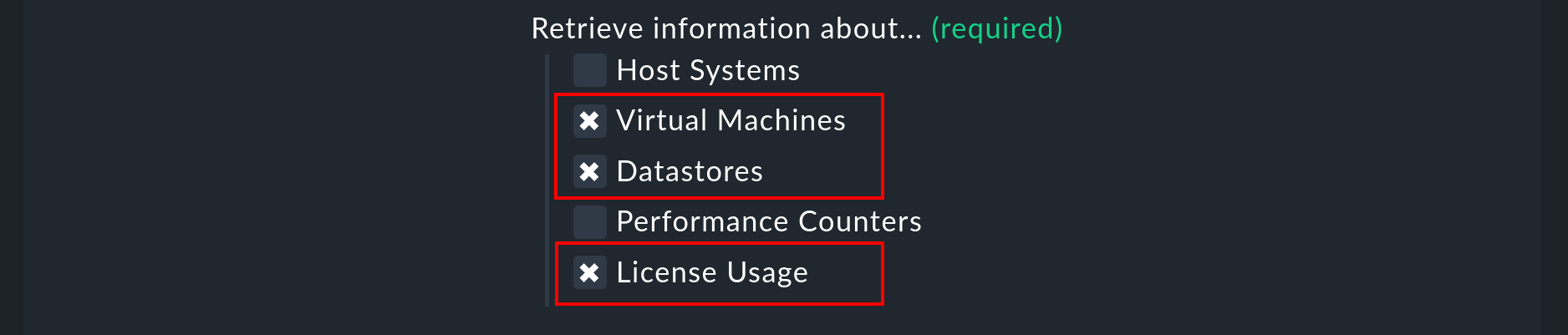

Retrieving from ESXi-Hosts and vCenter
In order to avoid duplicated data retrieval when using a combination of both configuration methods, the rule for the vCenter can be configured to retrieve only specific data. One possibility is to access the Datastores and the Virtual Machines over the vCenter, and the other data directly from the ESXi-hosts. The license usage can be fetched in both configurations since the vCenter reports an overall status.
vmware data1
If you have already configured the ESXi-hosts, its rules will be adapted accordingly. Here only access to the Host Systems and Performance Counters is available, since these belong unalterably to a particular ESXi server. The license status is applicable only to the retrieved ESXi server.
vmware data2

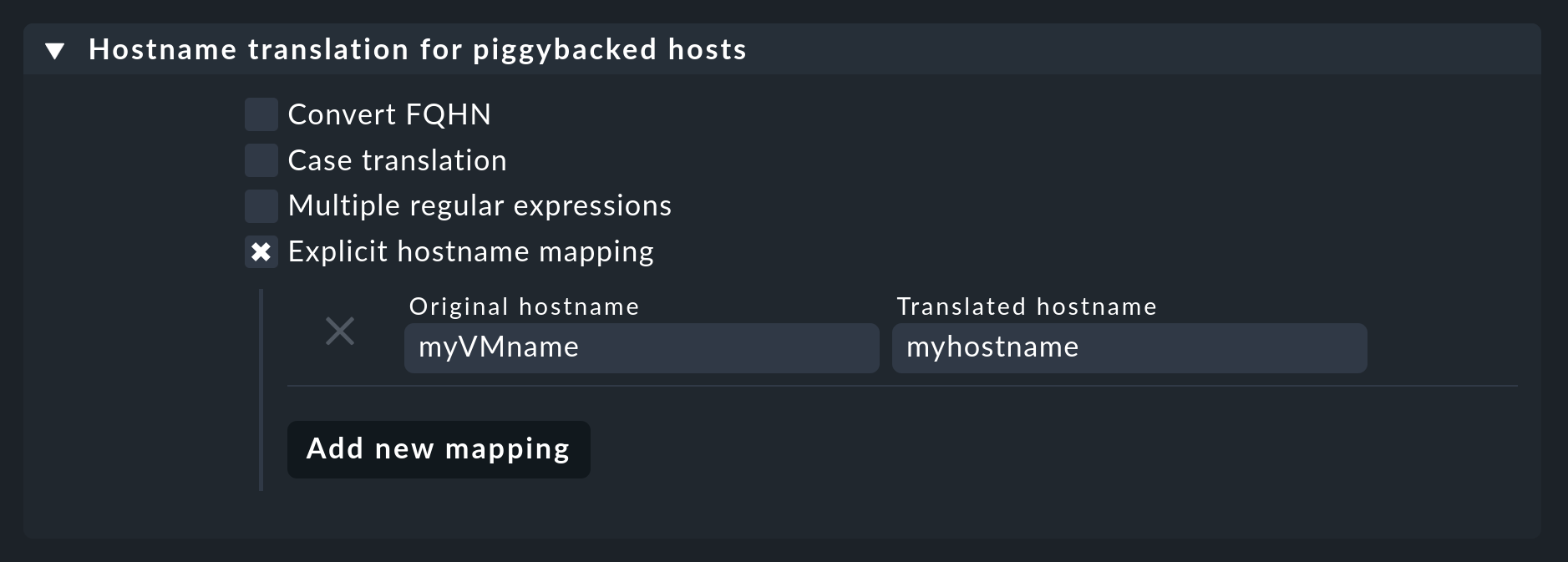

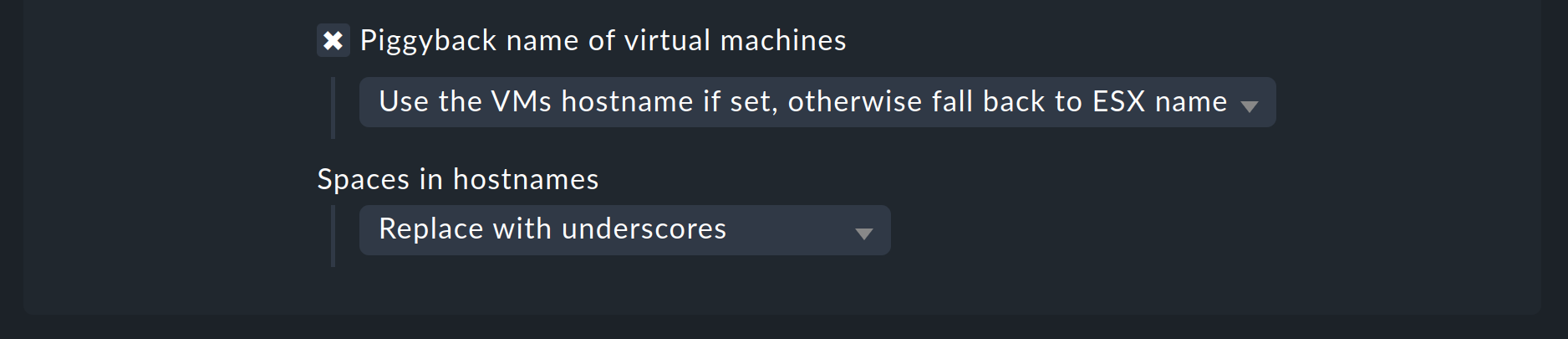

If the host name of the VM in Checkmk matches the name of the VM, the assignment works automatically. If not, there are various options in Checkmk to customize the piggyback name. The following options are available in the configuration rule itself:
  • You may use the VM’s operating system’s host name, if this can be accessed via the vSphere-API.
  • If the VM’s name includes blank characters, the name will be truncated after the first blank. Alternatively, the blanks can be replaced with underscores.
vmware nametranslation
If the host’s name is quite different in Checkmk, an explicit allocation can be performed with the help of the Setup > Agents > Access to agents > Host name translation for piggybacked hosts rule.
vmware nametranslation2

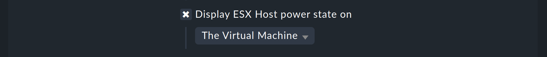

If the host is configured in Checkmk and the names conform, you can activate the Display VM power state on check box in the configurations rule — select if and where the data is to be made available. Select The Virtual Machine here.
vmware vms

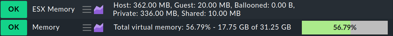

With a service discovery on the host(s) the new services will now be identified and can be activated. Be aware that the information from the services could differ from one another. The ESXi server will see a virtual machine’s RAM usage differently to how the machine’s own OS reports it.
vmware services

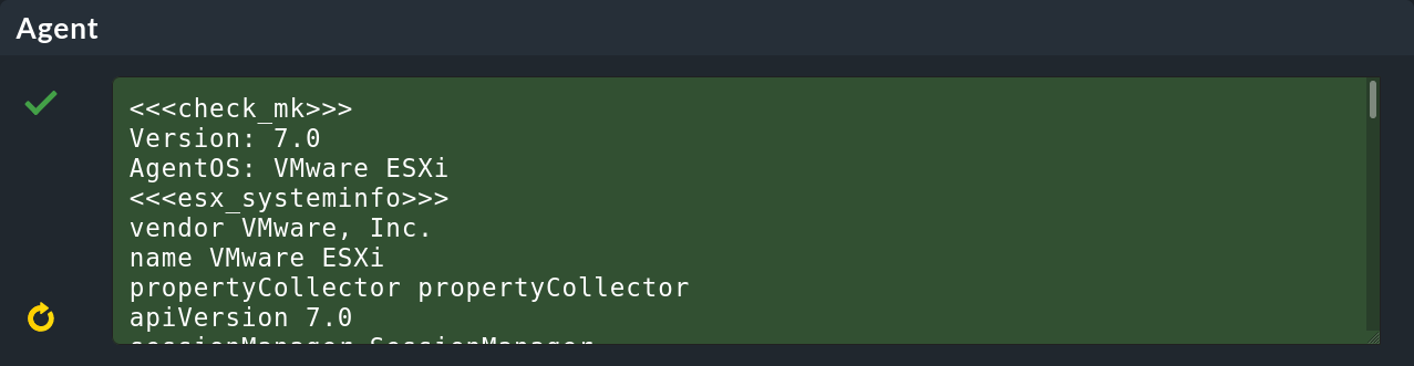

Alternatively, you can carry out the test on the host’s diagnostic page in the Setup:
vmware agent test
If everything works up to this point the output should have been saved to a temporary directory. Whether such a file has been produced, and whether the content is correct can be determined with the following:
