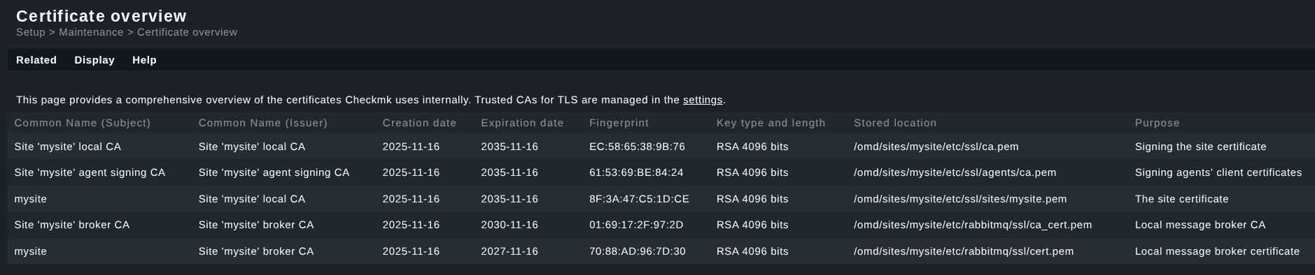

Open the Certificate overview page via Setup > Maintenance > Certificate overview. Here at a glance you will find all of the basic certificates that were created and stored on the Checkmk side when setting up your site. This page is for informational purposes only and serves as an internal quick access point – for example, to check the validity and fingerprints of the preinstalled certificates. If you suspect problems with certificates, the overview can speed up troubleshooting. The Certificate overview page is the first place to go for this.
“The 'Certificate Overview' page in Checkmk.”
Overview of Checkmk certificates
The Certificate overview page lists the certificates of the Checkmk components with their metadata: in the Common Name (Subject) section, you will find the certificates that have been issued, and under Common Name (Issuer) their issuer (Certificate Authority), each with their corresponding creation and expiration dates. For each certificate the individual fingerprint, key type (RSA), key length in bits, storage location with file path, and a brief description of its function (Purpose) are stored in addition to the term. The complete fingerprint is displayed as a tooltip (mouse-over text) for the respective fingerprint entry when you move the mouse over the entry. Feel free to take a look at your own site for orientation; the key length and other elements may differ from the example.
Three certificate authorities (CA) are always generated individually as trusted issuers of certificates when creating a Checkmk site. The page lists their CA certificates: one CA certificate each for signing the site certificate, one CA certificate for the agent keys during mTLS authentication, and one CA certificate for the message broker certificates at RabbitMQ.
By default, five certificates are listed for a single site. In distributed monitoring the certificate overview of your central site contains an additional entry for each connected remote site, as each remote site receives a remote site certificate to confirm the authenticity of the key used for communication between the central and remote sites.
