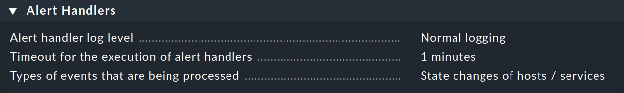

4.6. Global settings
There are a number of global settings for executing alert handlers:
alert handlers options
The Alert handler log level influences the logging in the alert helper log file (~/var/log/alerts.log).
